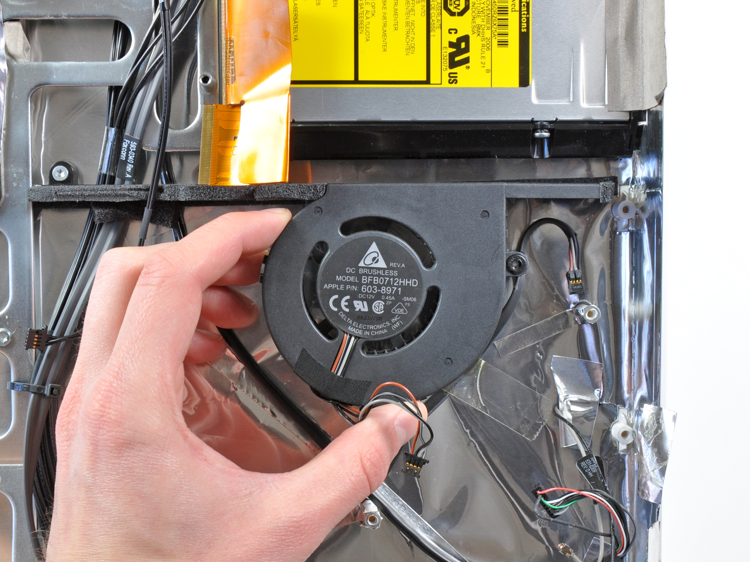

Add Note Edit Step 34 — Optical Drive Fan  ¶
  • Lift the optical drive fan off the plastic posts protruding from the rear case.
  • During reinstallation, be sure to re-route the cable the way you found it.
