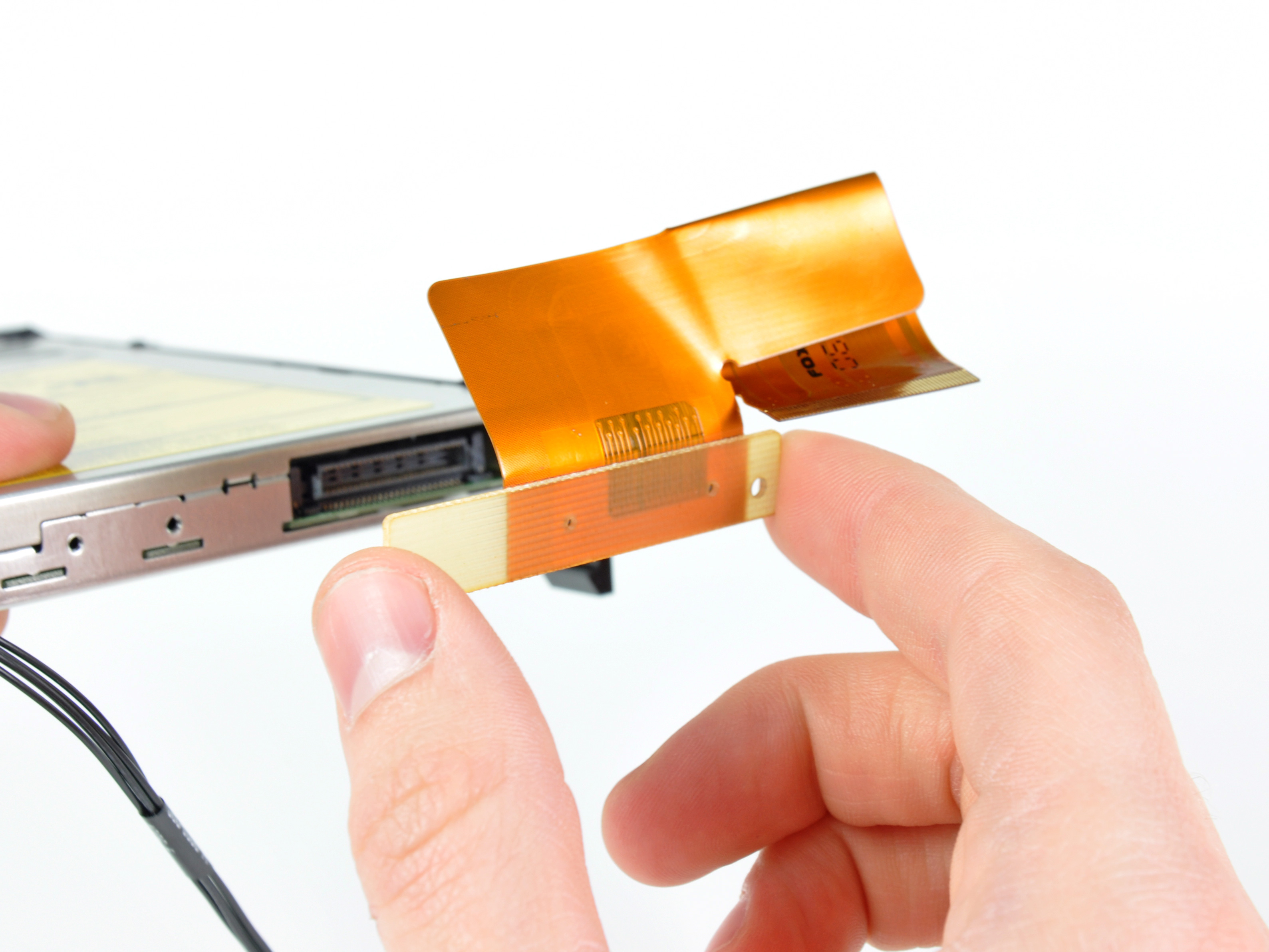

Add Note Edit Step 20 — Optical Drive Cable  ¶
  • Remove the two T6 Torx screws securing the optical drive cable to the optical drive.
first image
Add Note Edit Step 21  ¶
  • Insert the flat end of a spudger into the gap between the optical drive cable connector and the optical drive.
  • Twist the spudger to separate the connector from the optical drive.
  • Repeat this process for both sides of the connector.
first image
Add Note Edit Step 22  ¶
  • Pull the optical drive cable connector away from the optical drive.
