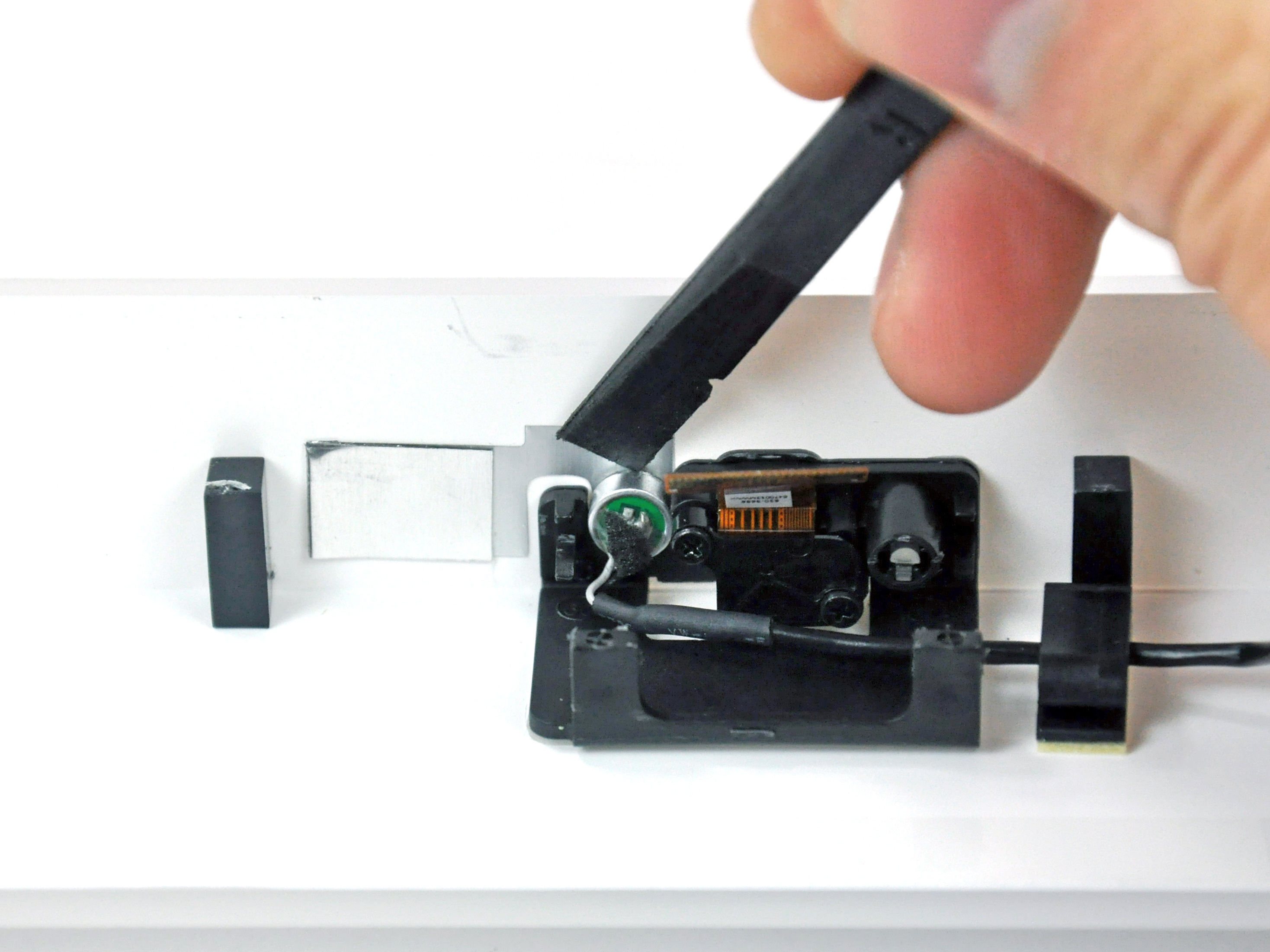

Add Note Edit Step 11 — Microphone  ¶
  • Use the tip of a spudger to remove the foam bumper covering the microphone.
first image
Add Note Edit Step 12  ¶
  • Use the flat end of a spudger to pry the microphone off the adhesive holding it to the front bezel.
