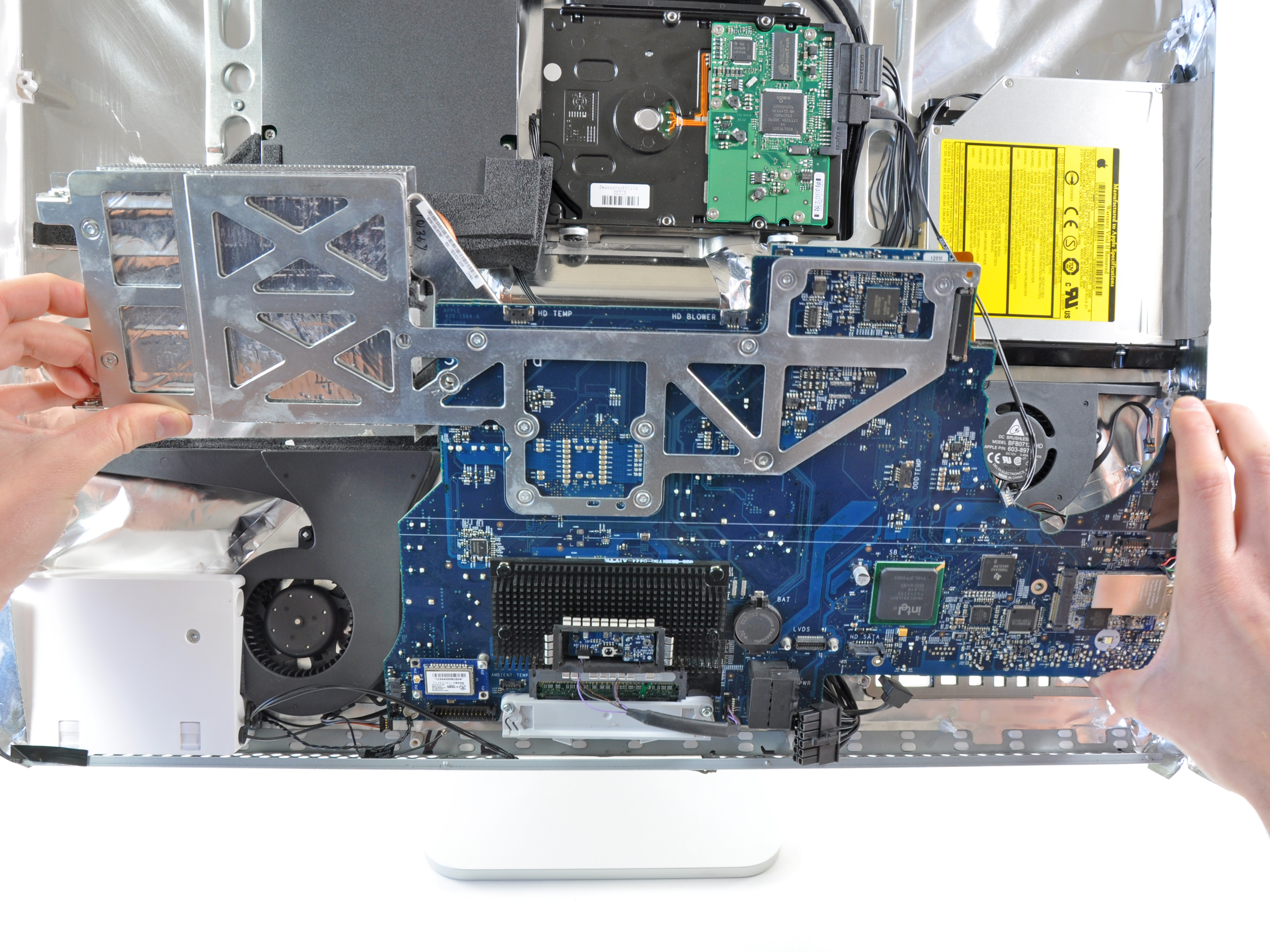

Add Note Edit Step 33  ¶
  • Pull the right edge of the logic board slightly away from the rear case to dislodge the rear I/O ports from their bezel.
  • Tilt the top edge of the board away from the rear case and lift the logic board assembly out of the rear case, minding any cables that may get caught.
  • When reinstalling the logic board, it is helpful to use tape to temporarily tuck the cables out of the way until the board is properly seated in the rear case.
