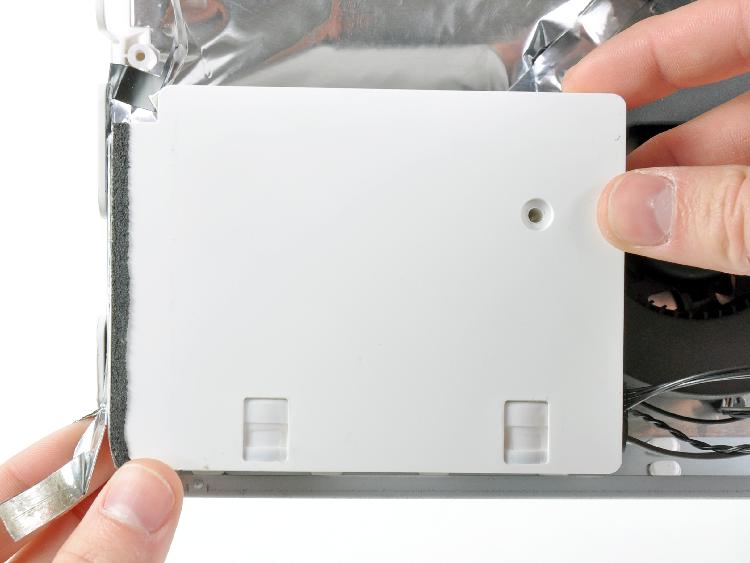

Add Note Edit Step 35 — Left Speaker  ¶
  • Remove the pieces of tape securing the left speaker cable to the rear case.
  • We have found it easier to just cut the tape near the cable for removal. During reinstallation, simply apply a new piece of tape over the cable.
first image
Add Note Edit Step 36  ¶
  • De-route the left speaker cable from beneath the framework near the center of the iMac.
first image
thumb image 1
thumb image 2
Add Note Edit Step 37  ¶
  • Peel back the strip of EMI tape near the bottom edge of the left speaker.
  • Pull the EMI tape away from the bottom corner of the left speaker.
first image
Add Note Edit Step 38  ¶
  • Remove the 38 mm T10 Torx screw securing the left speaker to the rear case.
first image
Add Note Edit Step 39  ¶
  • Pull the left speaker out of the iMac, minding any cables that may get caught.
  • If your replacement left speaker does not have an ambient temperature sensor attached, use the edge of a spudger to peel it off the existing speaker and transfer it to your new speaker.
