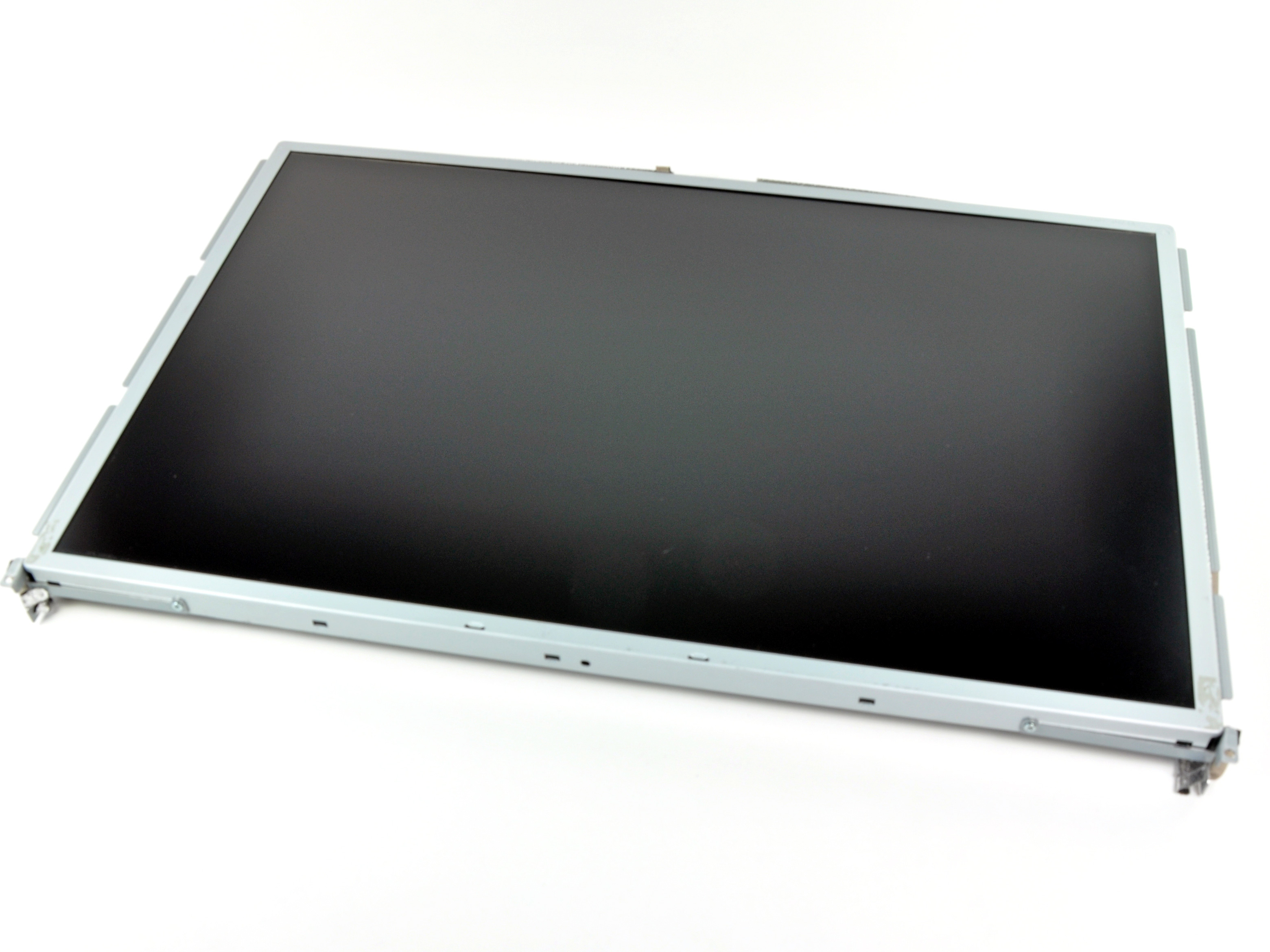

Add Note Edit Step 24 — LCD  ¶
  • LCD remains.
