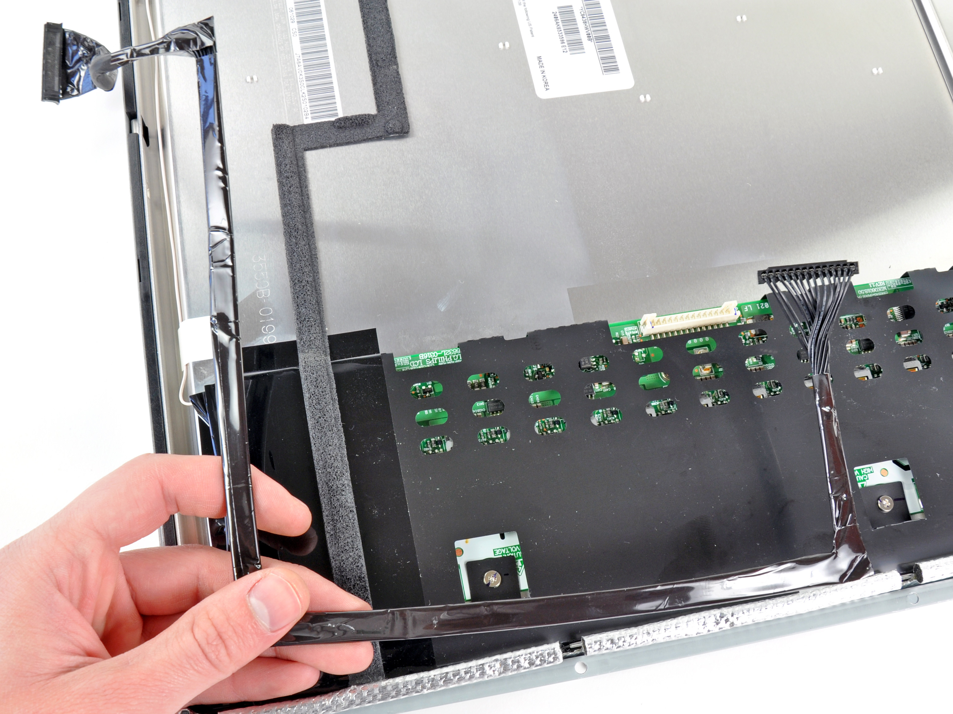

Add Note Edit Step 13 — Inverter Cable  ¶
  • Remove the large piece of tape covering the inverter cable connector and any tape securing the cable to the inverter board.
first image
Add Note Edit Step 14  ¶
  • Lift the inverter cable connector straight up from its socket on the inverter board.
first image
Add Note Edit Step 15  ¶
  • Remove the inverter cable from the LCD.
