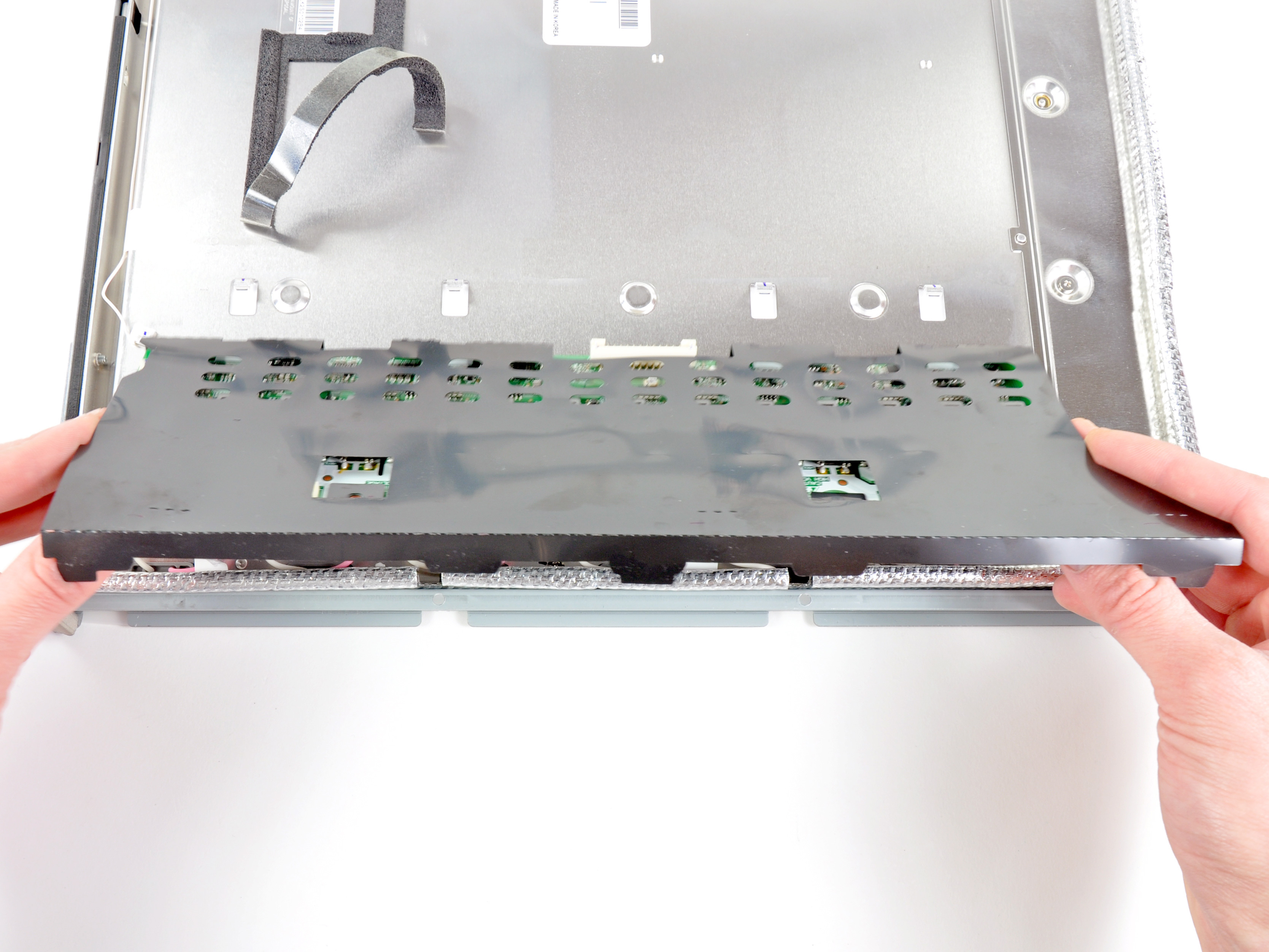

Add Note Edit Step 7 — Display Assembly  ¶
  • Peel the two highlighted EMI shield tabs off the frame of the LCD.
Image #1
Add Note Edit Step 8  ¶
  • Remove the two T6 Torx screws securing the display data cable to the logic board.
