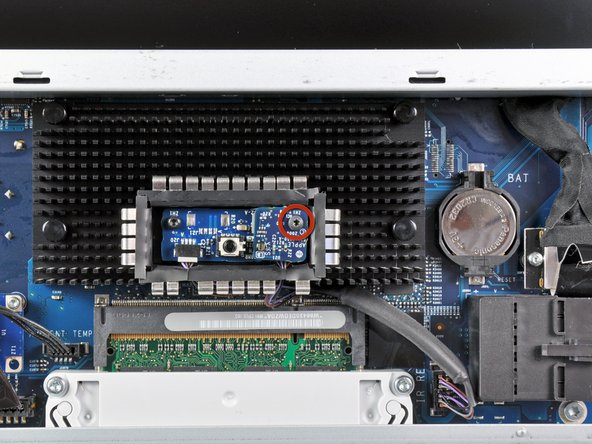

Add Note Edit Step 7 — IR Board  ¶
  • The IR board is located above the RAM modules socket, near the lower, center portion of the iMac.
  • Remove the single T6 Torx screw securing the small IR board.

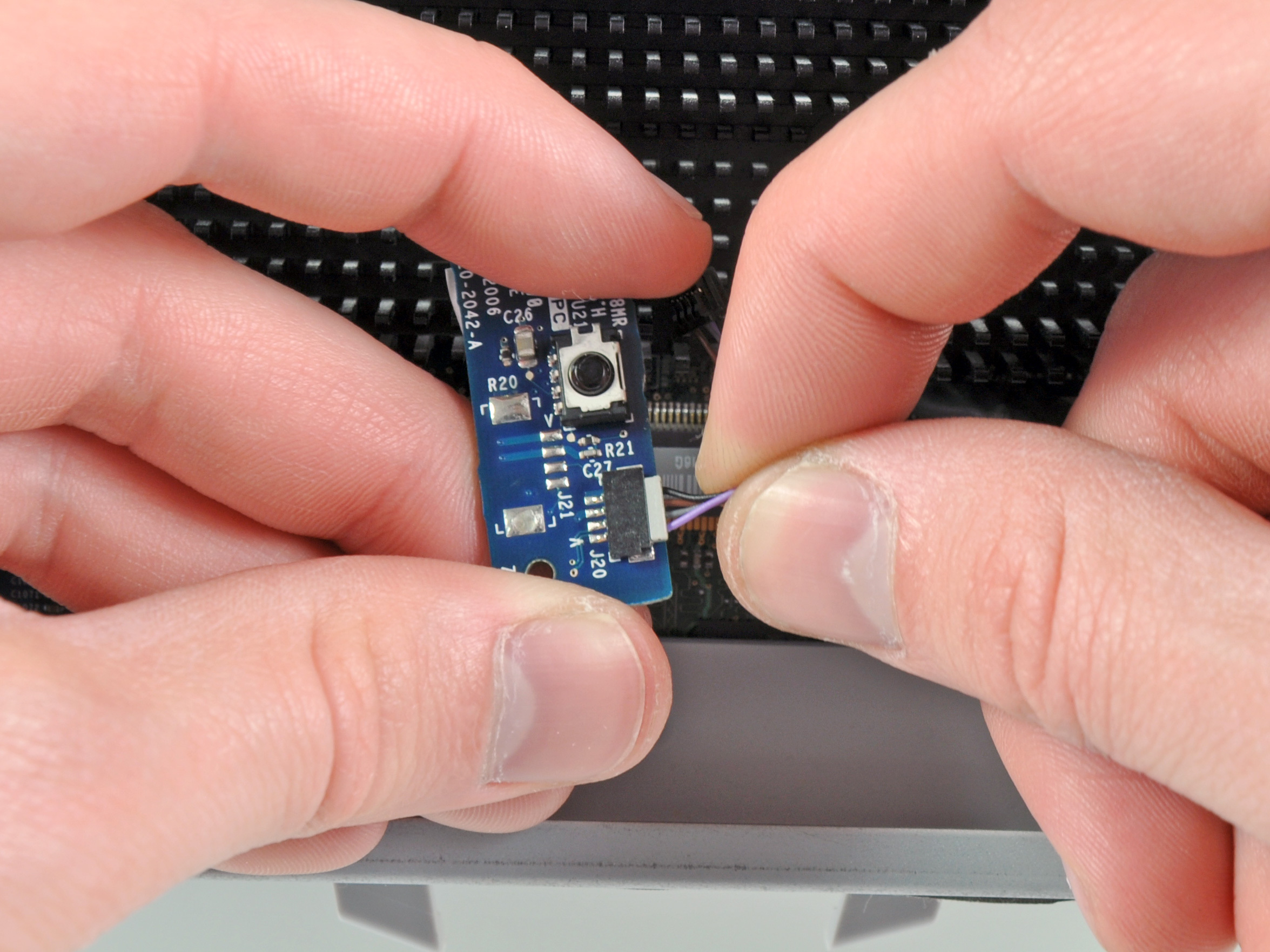

Add Note Edit Step 8  ¶
  • Pull the small IR board slightly away from the iMac and disconnect its cable.
  • Set it aside.

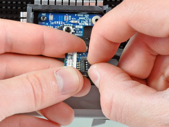

Add Note Edit Step 10  ¶
  • Disconnect the second IR board and remove it from the iMac.
