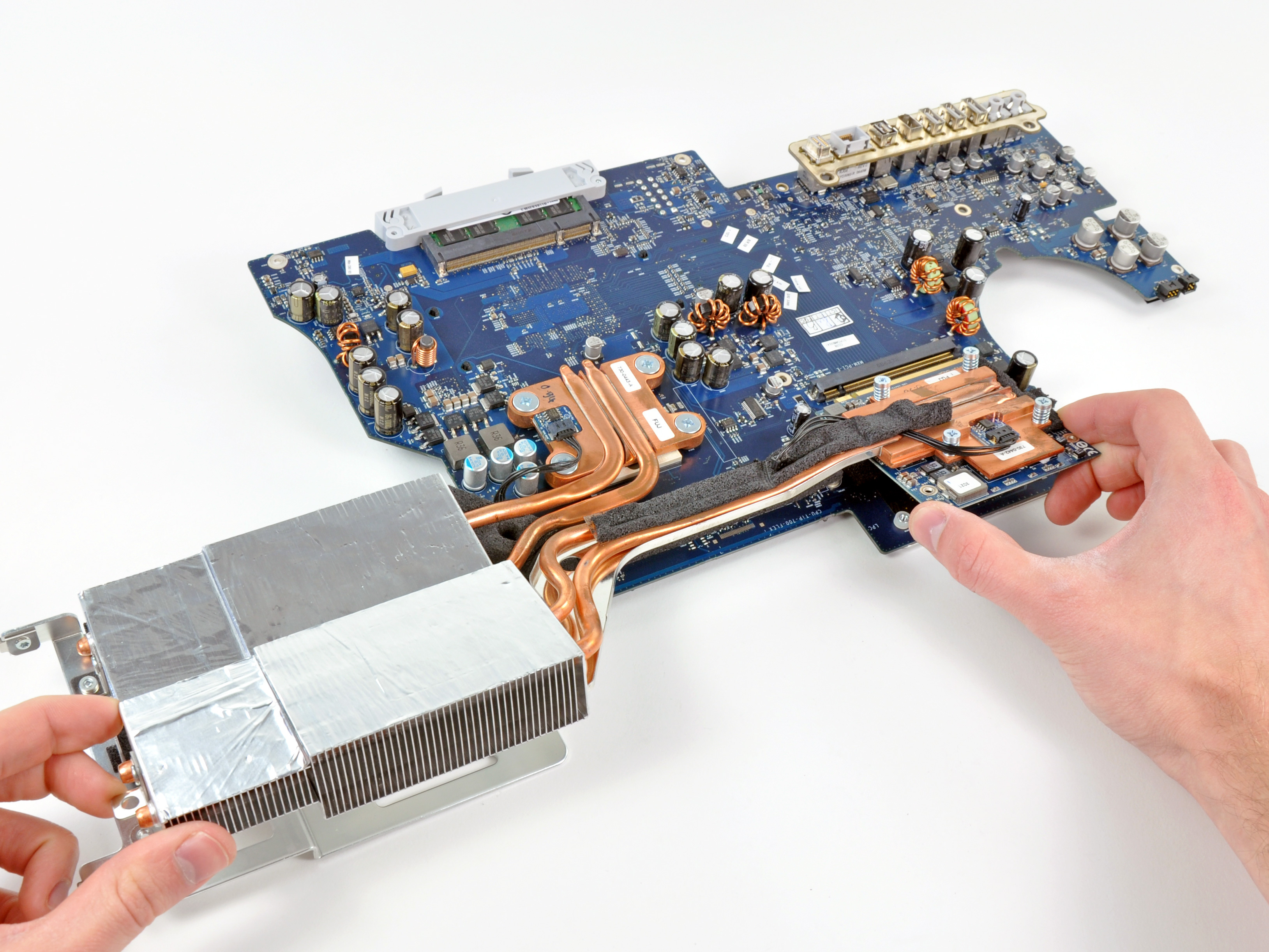

Add Note Edit Step 34 — GPU Assembly  ¶
  • Remove the short T10 Torx screw securing the GPU heat sink to the metal logic board framework.
  • This picture was taken with the top edge of the logic board nearest the bottom of the picture.
first image
Add Note Edit Step 35  ¶
  • Disconnect the GPU thermal sensor cable from the logic board.
first image
Add Note Edit Step 36  ¶
  • Remove the two T8 Torx screws securing the GPU to the logic board.
first image
Add Note Edit Step 37  ¶
  • Angle the top edge of the GPU away from the logic board and pull it out of its socket on the logic board.
  • Remove the GPU assembly.
