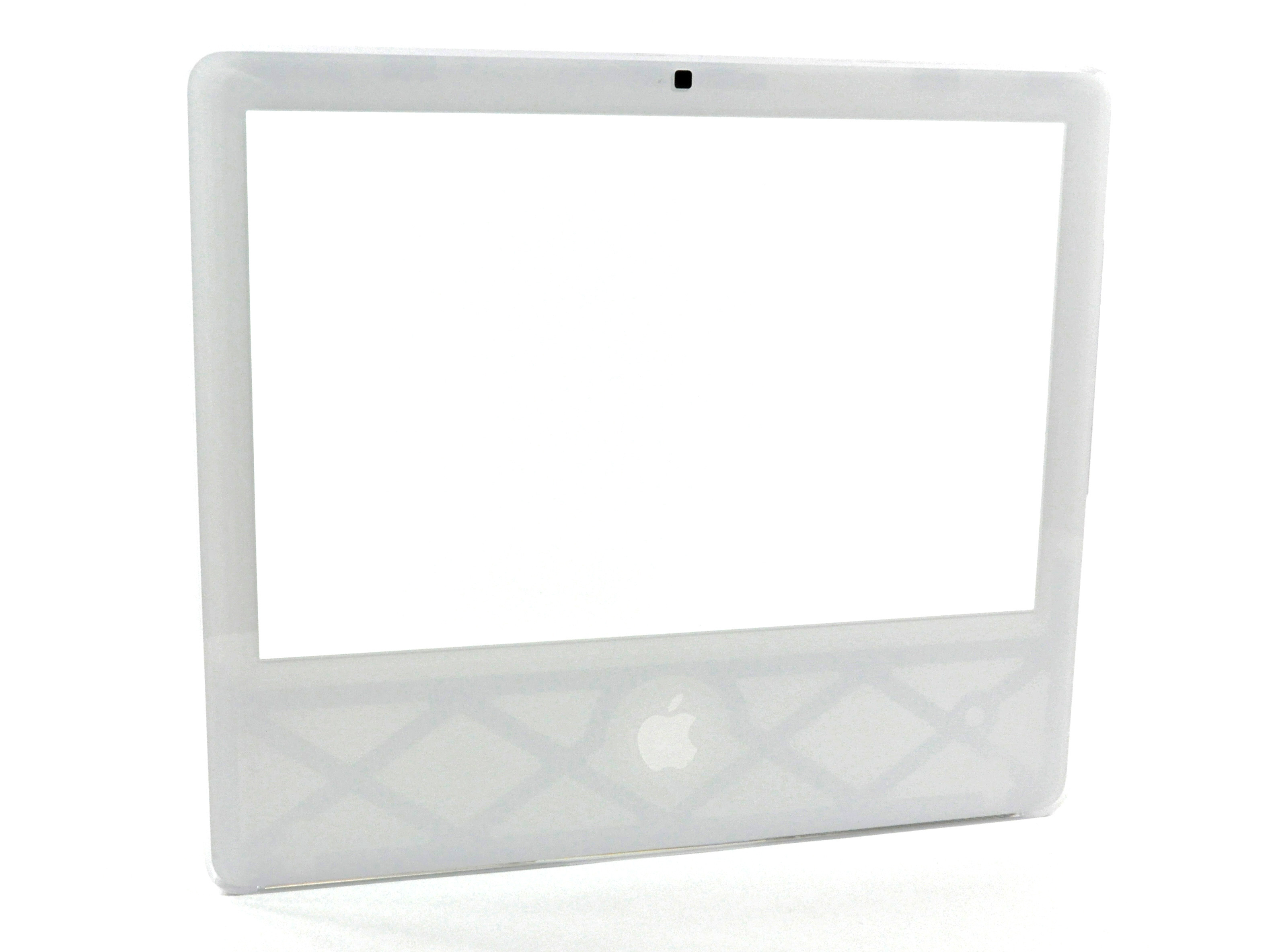

Installing iMac Intel 24" EMC 2111 Front Bezel Replacement
Replace the plastic front bezel on your iMac Intel 24" EMC 2111.
  • Add Note x
Use this guide to replace a damaged plastic front bezel.

Add Note Edit Step 15 — Front Bezel Replacement  ¶
  • Front bezel remains.
