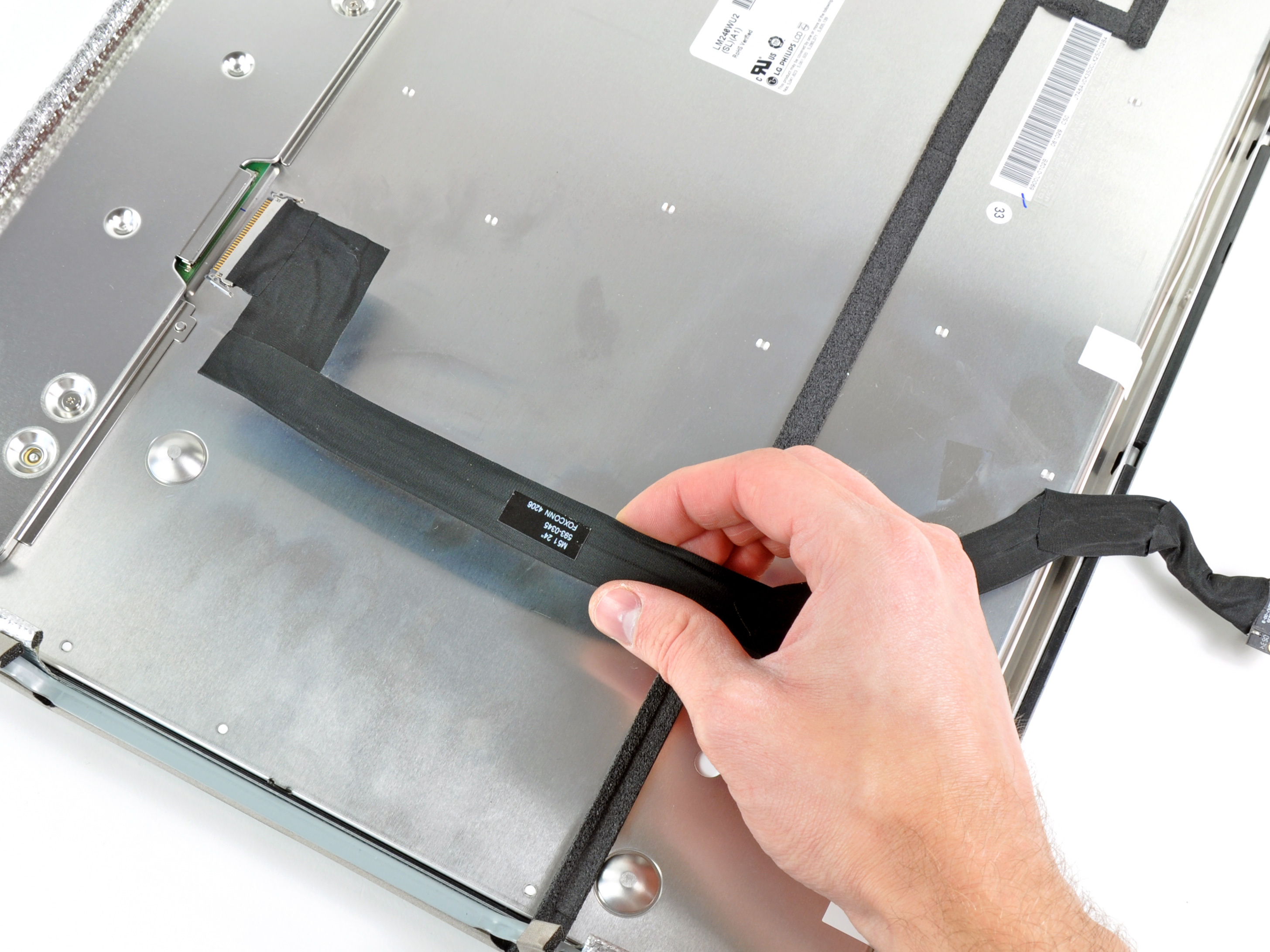

Add Note Edit Step 13 — Display Data Cable  ¶
  • Remove the two pieces of tape securing the display data cable to the back of the display.
first image
Add Note Edit Step 14  ¶
  • Squeeze the two retaining arms together and pull the display data cable connector out of its socket.
  • Pull the cable parallel to the rear face of the LCD. Pulling upward may damage the cable and/or the LCD.
first image
Add Note Edit Step 15  ¶
  • Remove the display data cable.
