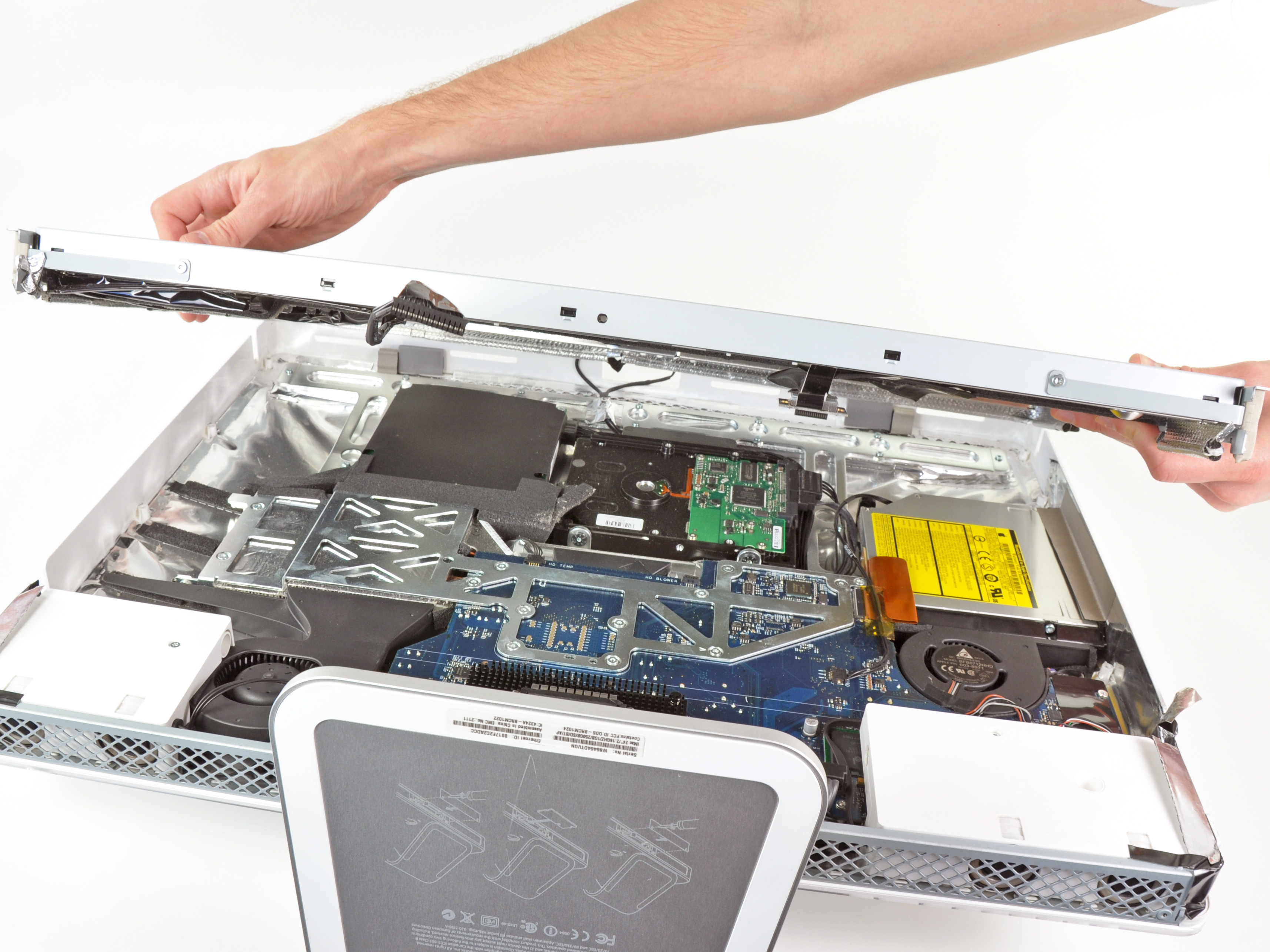

Add Note Edit Step 4  ¶
  • Lift the front bezel off the rear case and rotate it away from the bottom edge of the iMac, minding the camera and microphone cables still attached to its upper edge.
  • The third picture shows the top front bezel brackets and their slots cut into the top edge of the iMac's rear case.
  • Do not completely remove the front bezel, as it is still attached by the camera/microphone cables.
first image
