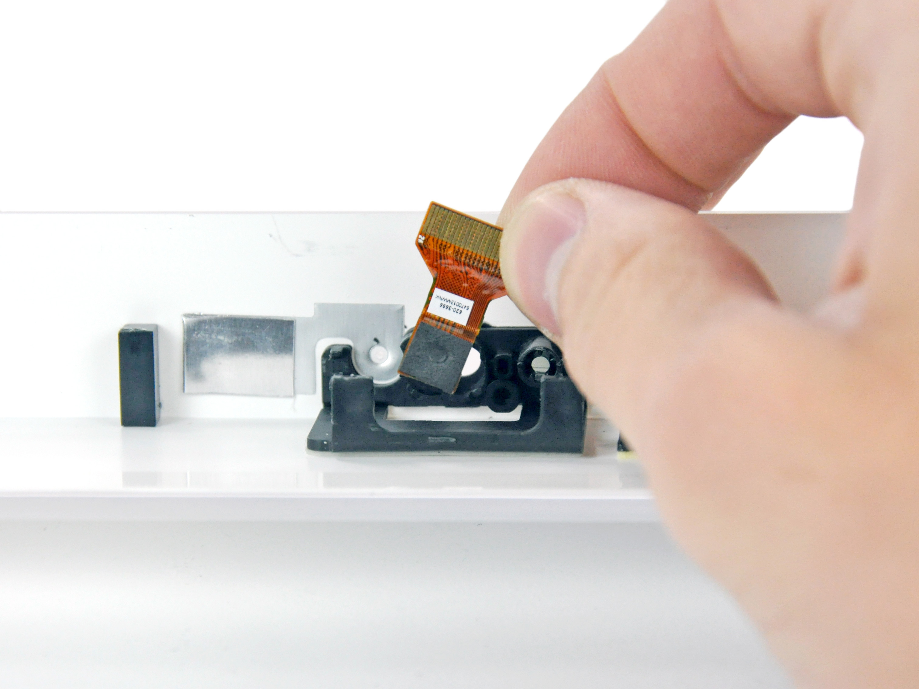

Add Note Edit Step 13 — Camera  ¶
  • Remove the two Phillips screws securing the camera to the camera bracket.
  • Remove the small black plastic camera bracket from the front bezel.
first image
Add Note Edit Step 14  ¶
  • Pull the camera lens away from the camera bracket and remove it from the front bezel.
