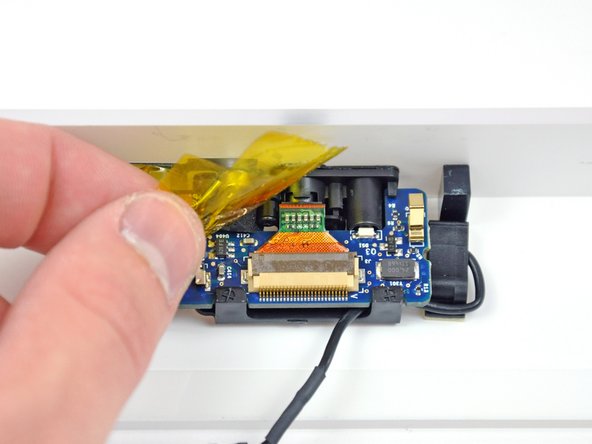

Add Note Edit Step 7 — Camera Board  ¶
  • If necessary, remove the strips of tape covering the camera board.
  • Don't forget to reapply tape to the face of the camera board to avoid electrical shorts.

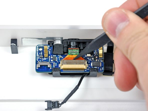

Add Note Edit Step 8  ¶
  • Use the tip of a spudger to flip up the camera ribbon cable retaining flap.
  • Flip the tab away from the front face of the front bezel.
  • Use the tip of a spudger to pull the camera ribbon cable away from its socket on the camera board.

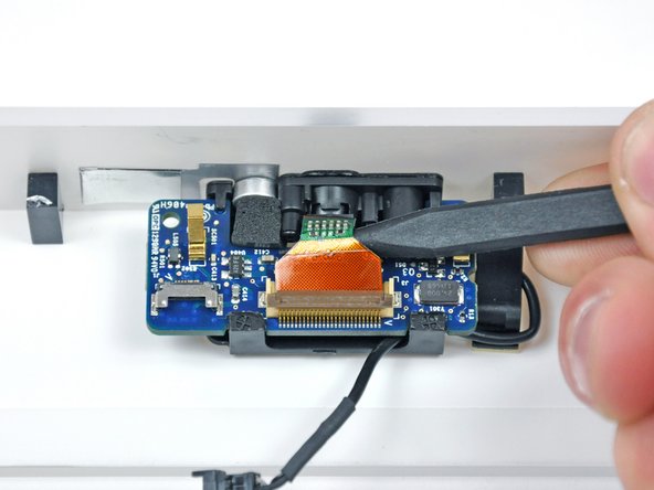

Add Note Edit Step 9  ¶
  • Rather than being held down by screws, the camera board is held down by a black plastic bracket attached to the front bezel.
  • In the next step, you will rotate the two black retaining clips (shown in red) away from the camera board to free it from the front bezel.

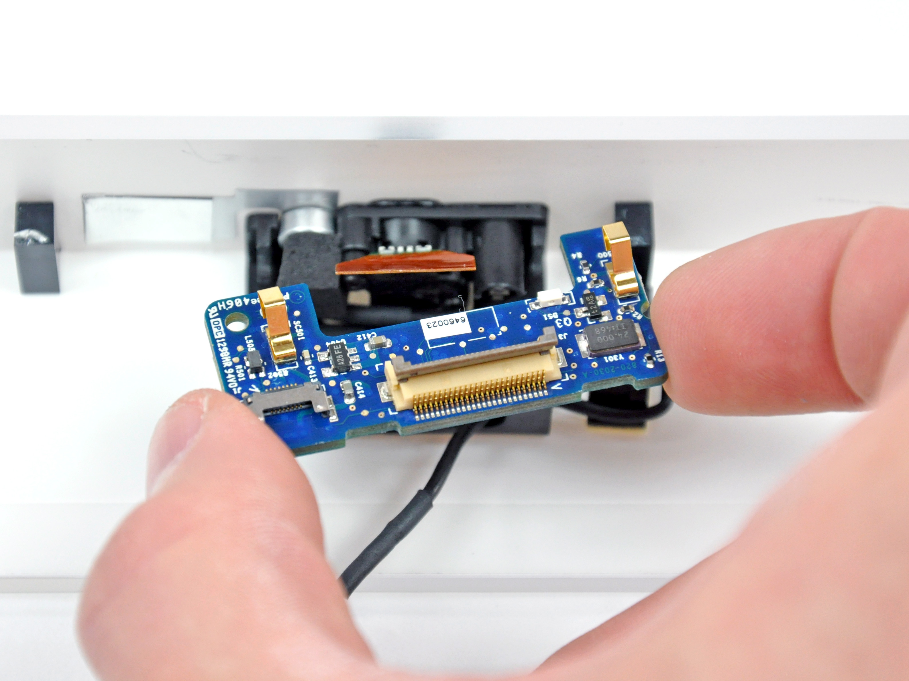

Add Note Edit Step 10  ¶
  • Use your thumbs to simultaneously rotate both retaining tabs away from the camera board while pushing the board up from either side with your index fingers.
  • Remove the camera board from the front bezel.
