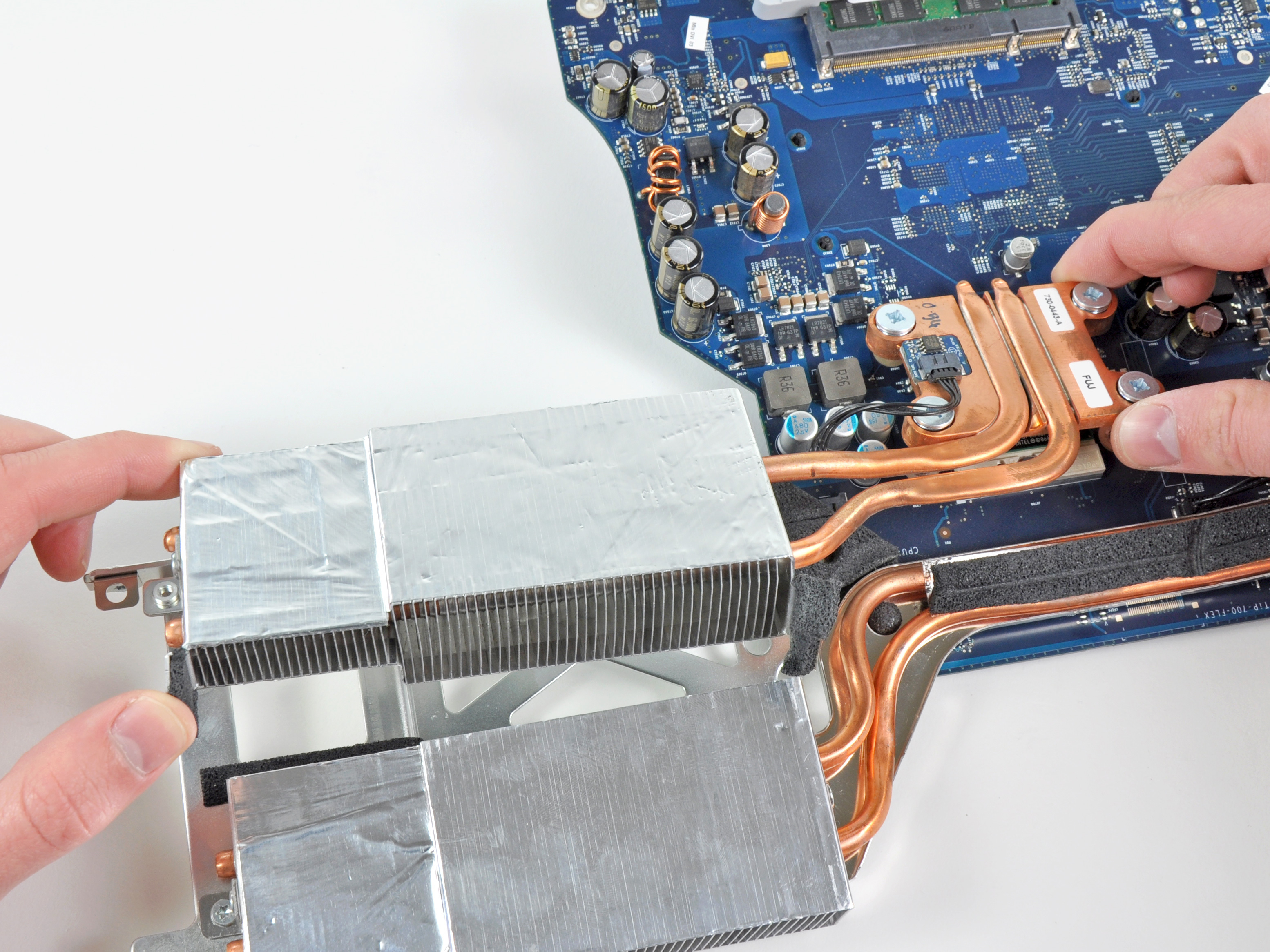

Add Note Edit Step 34 — CPU Heat Sink  ¶
  • Use the tip of a spudger to push the CPU thermal sensor cable connector out of its socket on the logic board.
  • It is helpful to push the connector from alternating sides to "walk" it out of its socket.
first image
thumb image 1
thumb image 2
Add Note Edit Step 35  ¶
  • Flip the logic board over so it is heat sink side down.
  • Remove the following T10 Torx screws.
    • One short screw near the end of the heat sink.
    • Four screws around the CPU itself.
  • It may be necessary to use a #1 Phillips screwdriver to hold the spring loaded screw bosses stationary while you remove the four screws around the CPU.
first image
Add Note Edit Step 36  ¶
  • Remove the CPU heat sink from the logic board.
  • Before reinstalling the CPU heat sink, be sure to apply a new layer of thermal paste. We have a guide that makes it easy.
