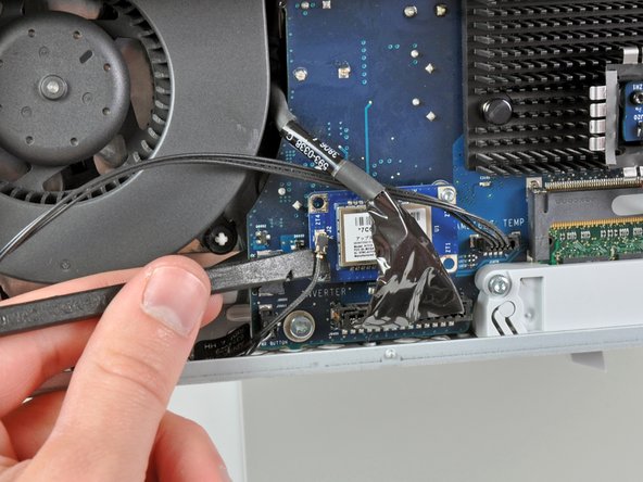

Add Note Edit Step 7 — Bluetooth Board  ¶
  • The Bluetooth Board is located on the lower left corner of the iMac, to the left of the RAM modules.
  • Use the flat end of a spudger to pry the Bluetooth antenna connector off the Bluetooth board.

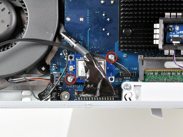

Add Note Edit Step 8  ¶
  • Remove the two T6 Torx screws securing the Bluetooth board to the logic board.
first image

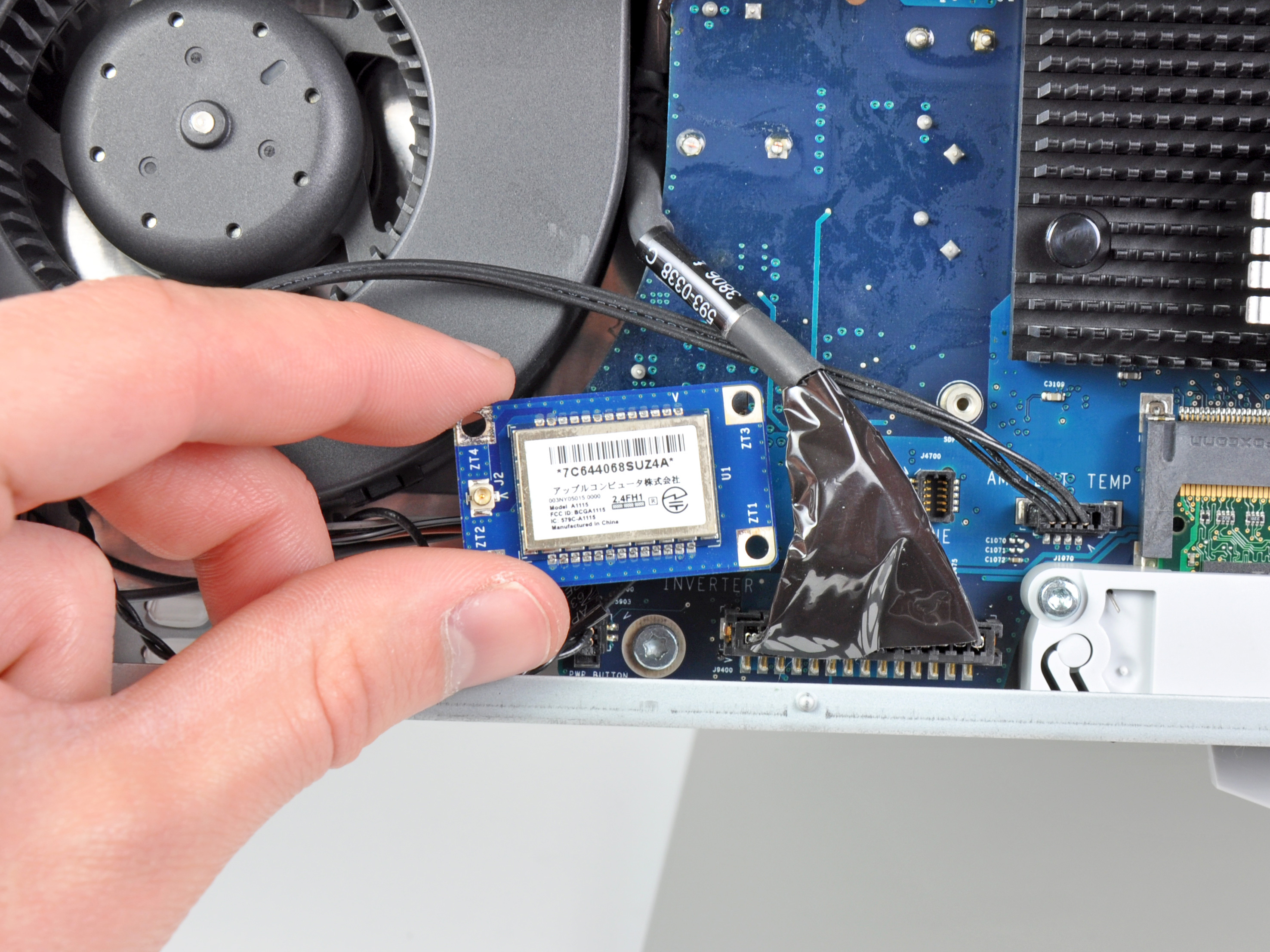

Add Note Edit Step 9  ¶
  • Use the flat end of a spudger to gently pry the right side of the Bluetooth board away from the logic board.
  • Maneuver the Bluetooth board out from under the inverter cable and remove it from the iMac.
