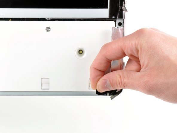

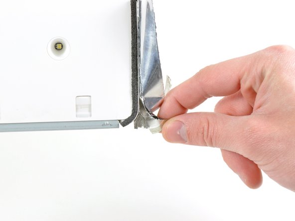

Add Note Edit Step 7 — AirPort Board  ¶
  • Peel back the piece of EMI tape connecting the bottom edge of the right speaker to the metal frame of the iMac.
  • Peel the tape away from the lower corner of the right speaker.

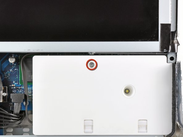

Add Note Edit Step 8  ¶
  • Remove the 26 mm T10 Torx screw securing the right speaker to the iMac.

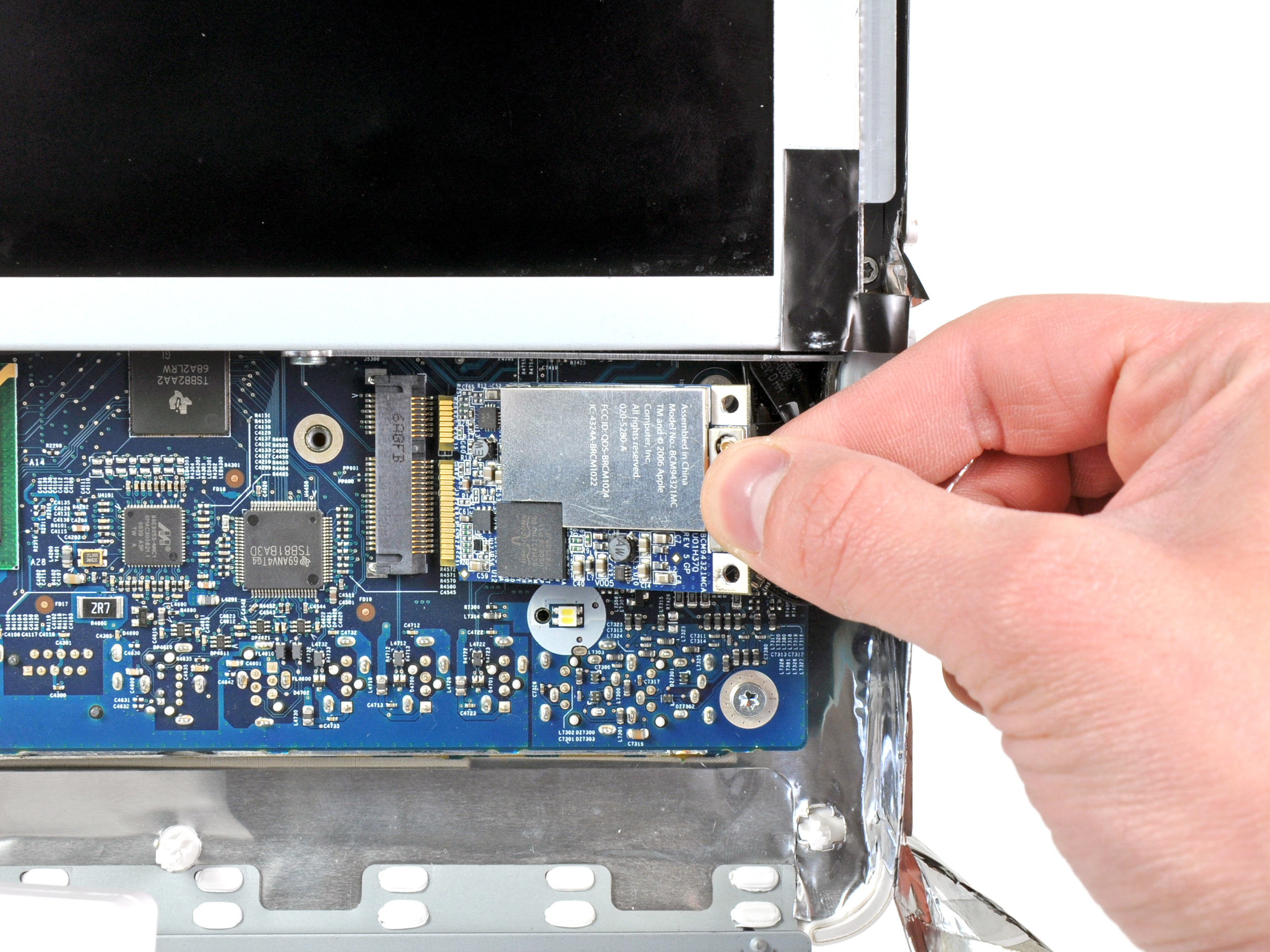

Add Note Edit Step 10  ¶
  • Use the flat end of a spudger to pry both antenna connectors off their sockets on the AirPort board.
  • The black antenna connects nearest the bottom edge of the iMac.

Add Note Edit Step 12  ¶
  • Pull the AirPort board out of its socket and remove it from the iMac.
