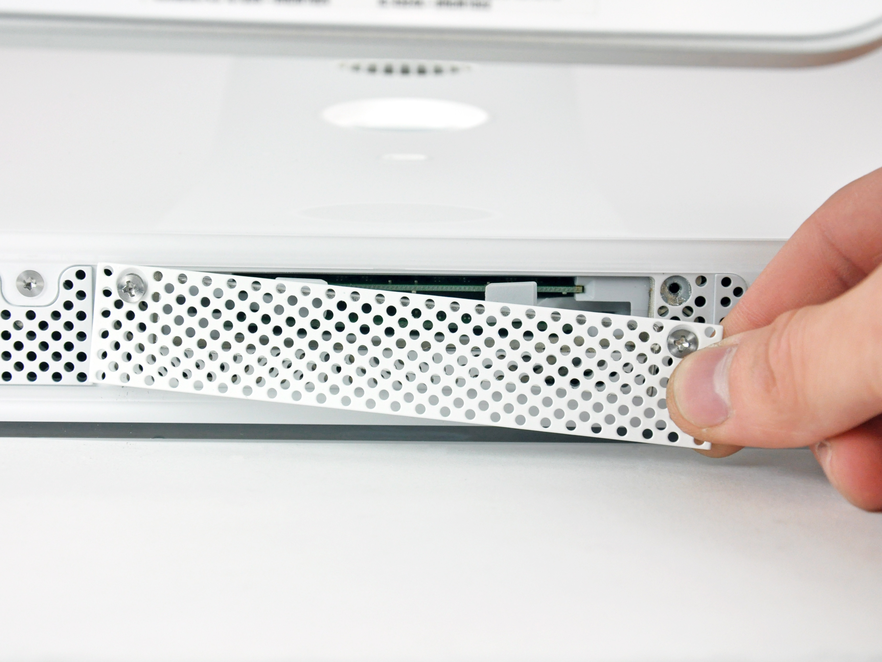

Add Note Edit Step 1 — Access Door  ¶
  • Loosen the two Phillips screws securing the access door to your iMac.
  • Both screws remain captive within the access door.
  • Remove the access door.
