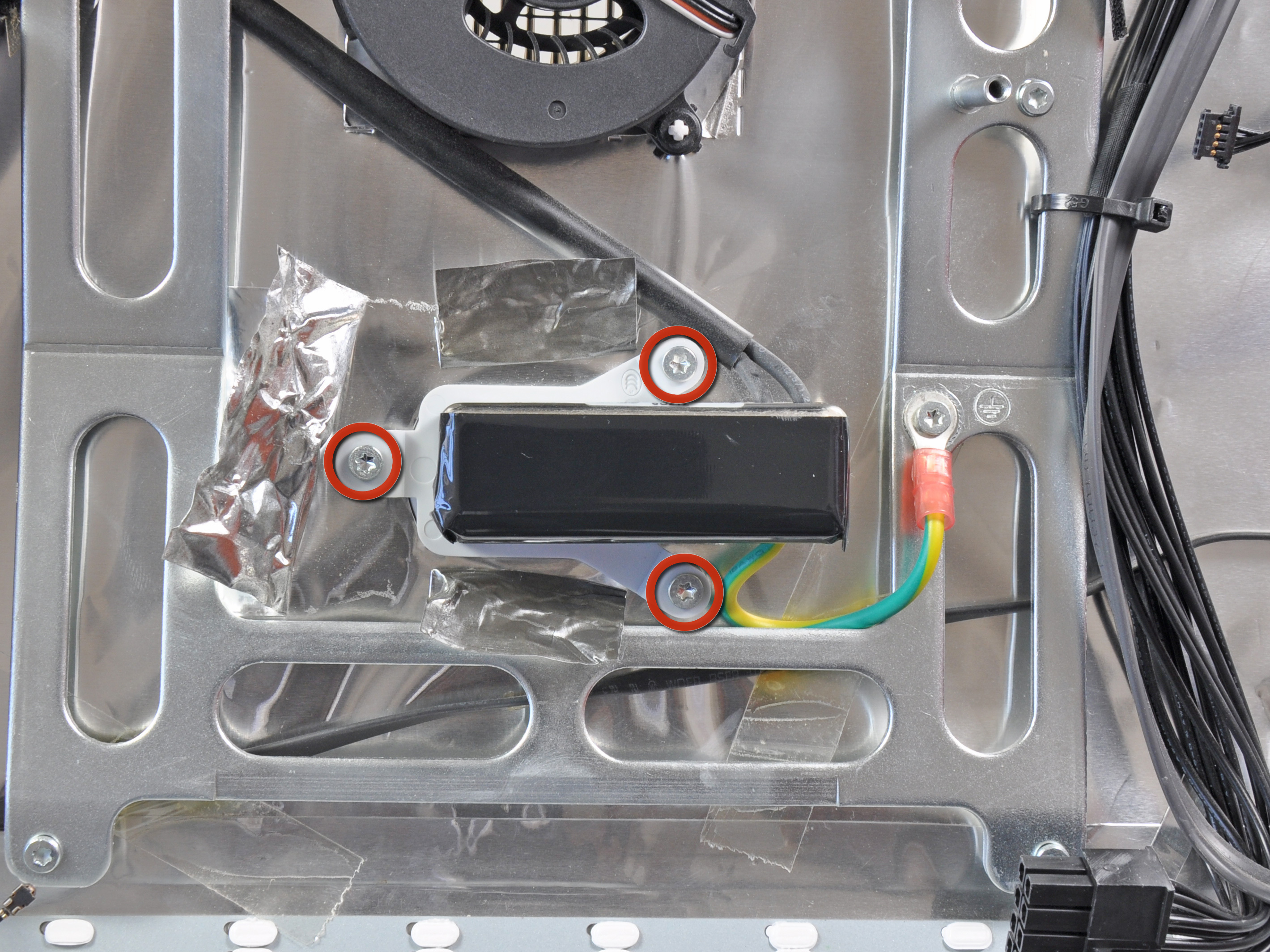

Add Note Edit Step 37  ¶
  • Peel the three pieces of aluminum tape away from the body of the AC inlet to reveal all three of its mounting screws.
first image
Add Note Edit Step 38  ¶
  • Remove the three T10 Torx screws securing the AC inlet to the rear case.
  • Remove the AC inlet.
