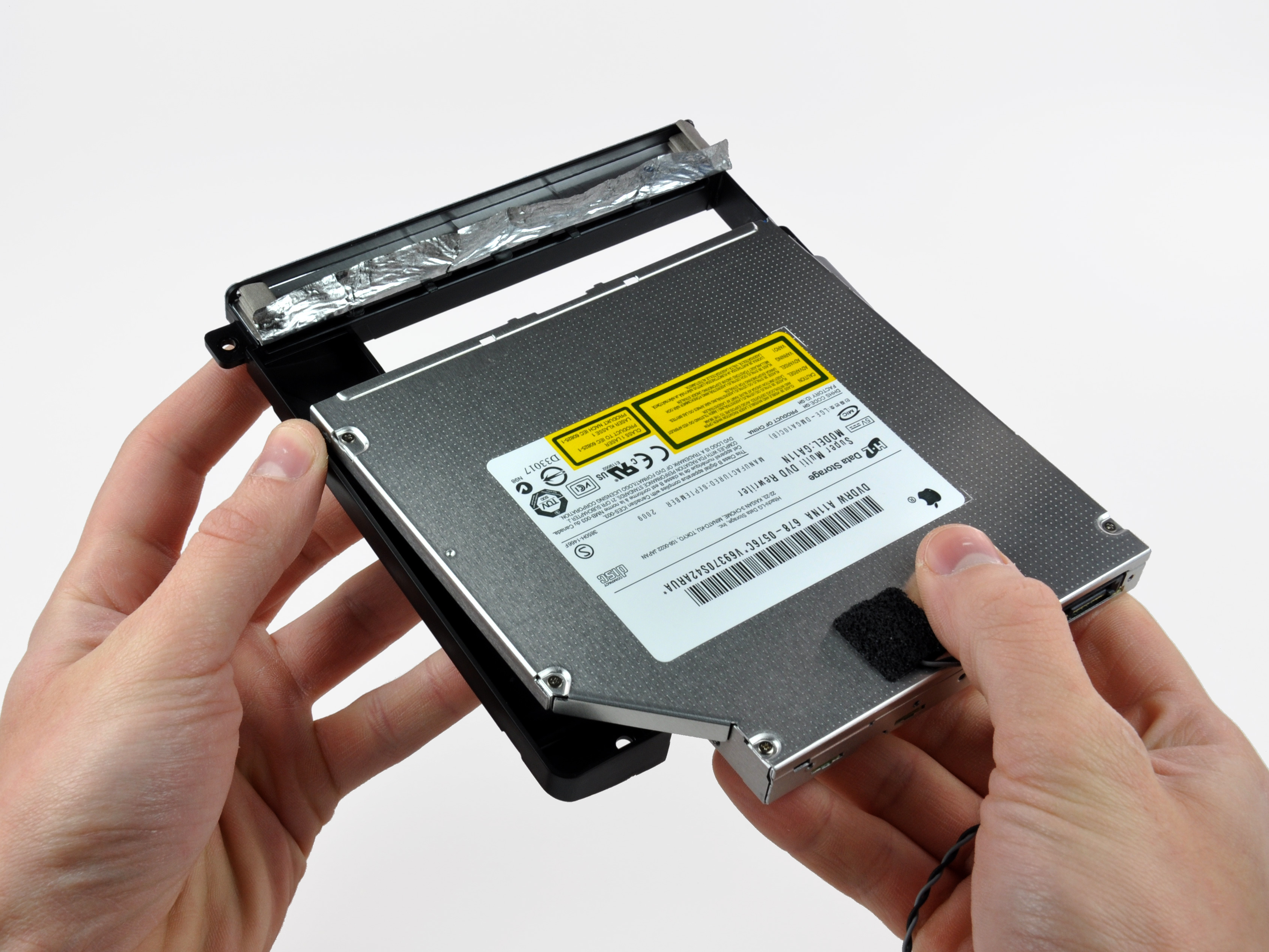

  14. iMac Intel 21.5" EMC 2428 Optical Drive Replacement, Optical Drive: step 14, image 1 of 2 iMac Intel 21.5" EMC 2428 Optical Drive Replacement, Optical Drive: step 14, image 2 of 2
    • It is not necessary to peel all of the EMI tape off the optical drive bracket. Only peel up the portion highlighted in red that is attached to the body of the optical drive.
    • Peel back the portion of aluminum tape highlighted in red, leaving the rest attached to the black plastic optical drive bracket.
  15. iMac Intel 21.5" EMC 2428 Optical Drive Replacement: step 15, image 1 of 2 iMac Intel 21.5" EMC 2428 Optical Drive Replacement: step 15, image 2 of 2
    • Remove the two T10 Torx screws from both sides of the optical drive (four screws total).
  16. iMac Intel 21.5" EMC 2428 Optical Drive Replacement: step 16, image 1 of 3 iMac Intel 21.5" EMC 2428 Optical Drive Replacement: step 16, image 2 of 3 iMac Intel 21.5" EMC 2428 Optical Drive Replacement: step 16, image 3 of 3
    • If necessary, use the tip of a spudger to press each of the optical drive bracket tabs out of their slots on the bottom of the optical drive.
    • Rotate the optical drive bracket slightly away from the optical drive.
    • Pull the optical drive bracket away from the open end of the optical drive, minding any tabs that may get caught.
