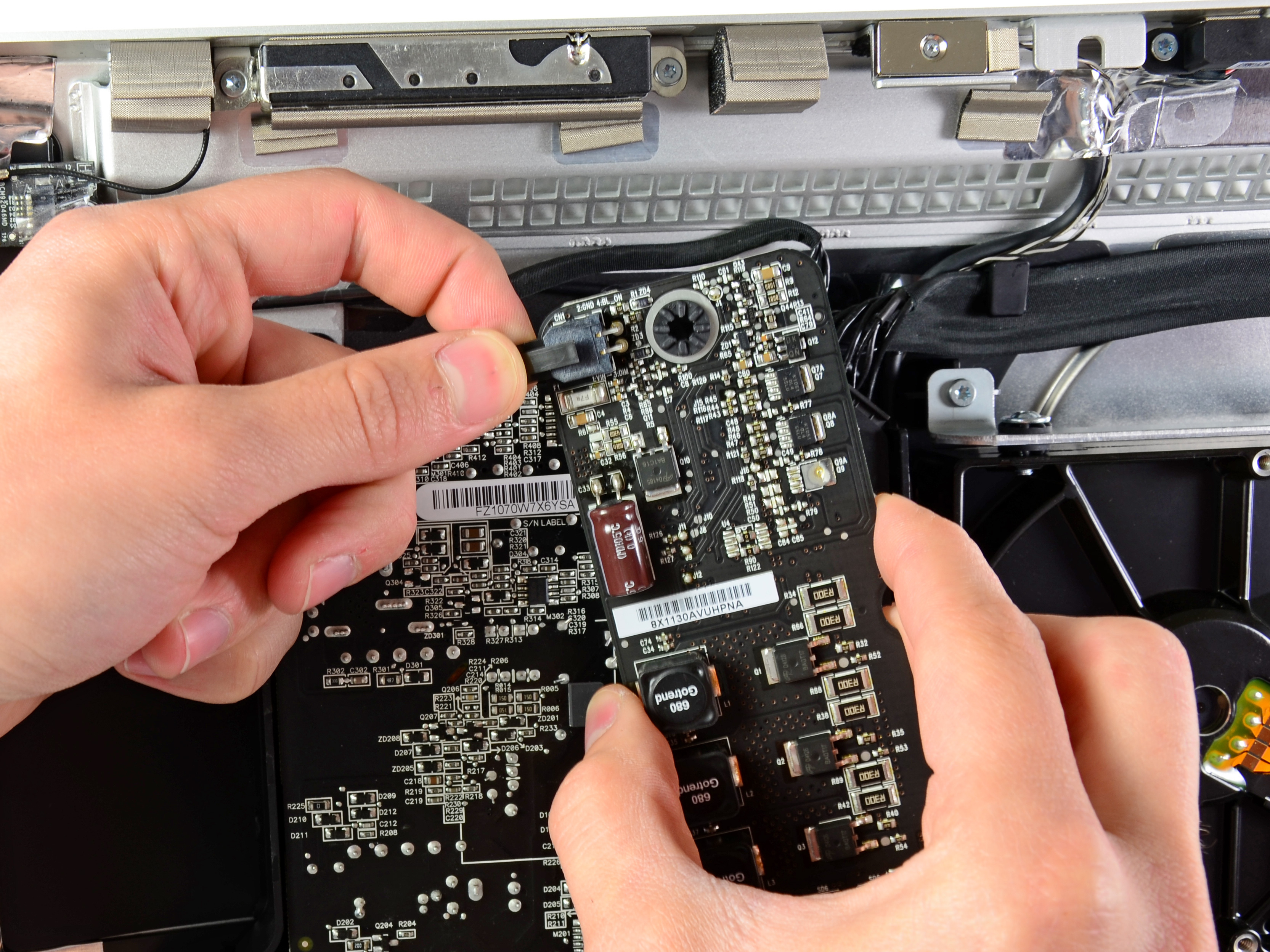

Add Note Edit Step 5  ¶
  • Pull the vertical sync cable connector out of its socket on the LED driver board near the top left corner of your iMac.
Image #1 Image #2
Add Note Edit Step 6  ¶
  • Rotate the display out of the outer case enough to disconnect the LED backlight power cable from the LED driver board.
  • Disconnect the LED backlight power cable by depressing the locking mechanism while pulling the connector away from its socket (toward the bottom edge of the iMac).
