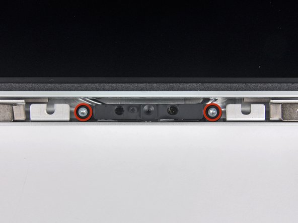

Add Note Edit Step 3 — Camera Board  ¶
  • Remove the two 5.2 mm shouldered T10 Torx screws securing the camera board to the outer case.

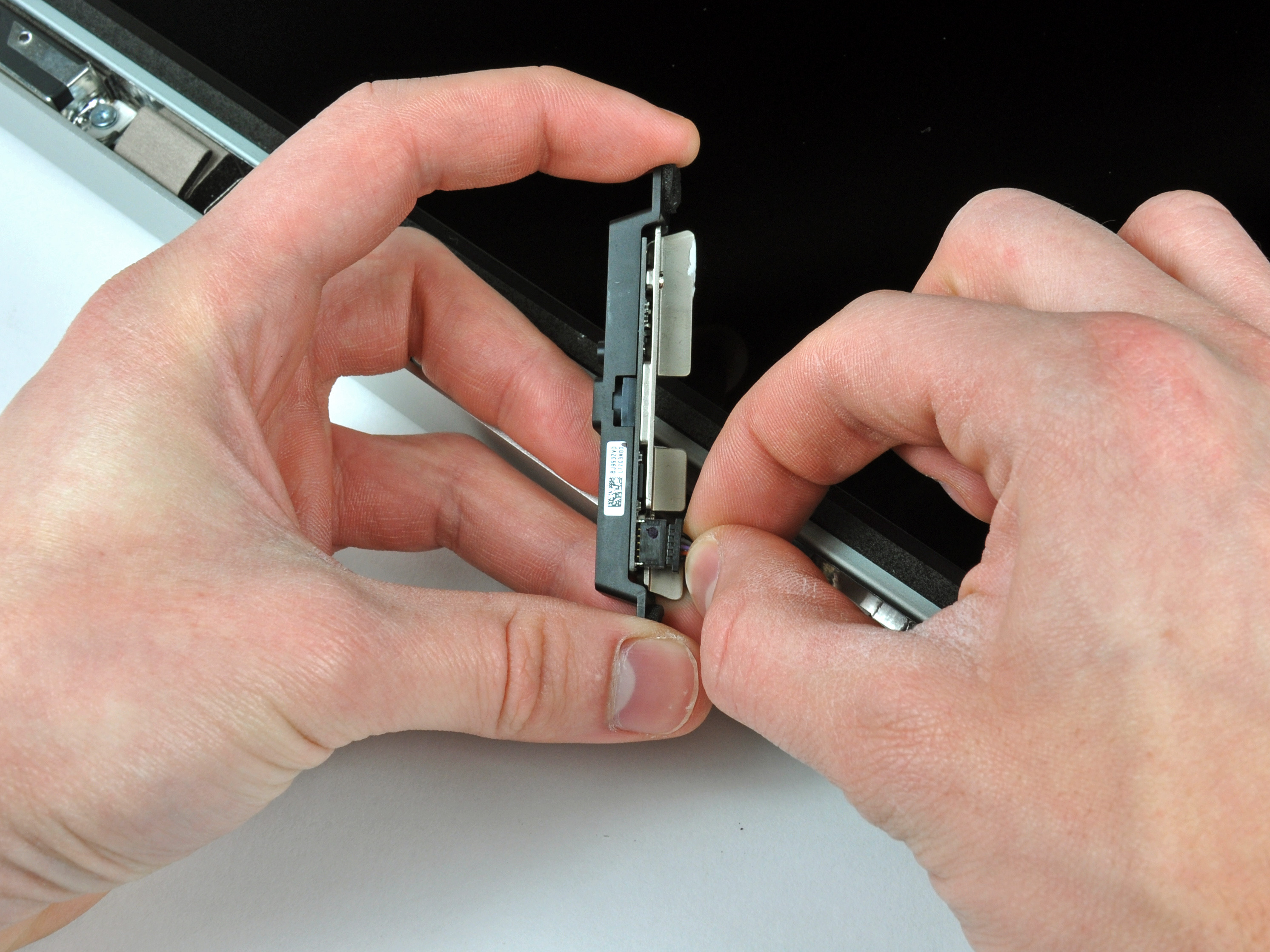

Add Note Edit Step 4  ¶
  • Lift the camera board out of the outer case, minding the cable attaching it to the logic board.
  • Disconnect the camera board by pulling its connector away from the socket on the camera board.
  • Before reinstallation, be sure that the thermal putty applied to the camera's heat sink is thick enough to make contact with the outer case.
