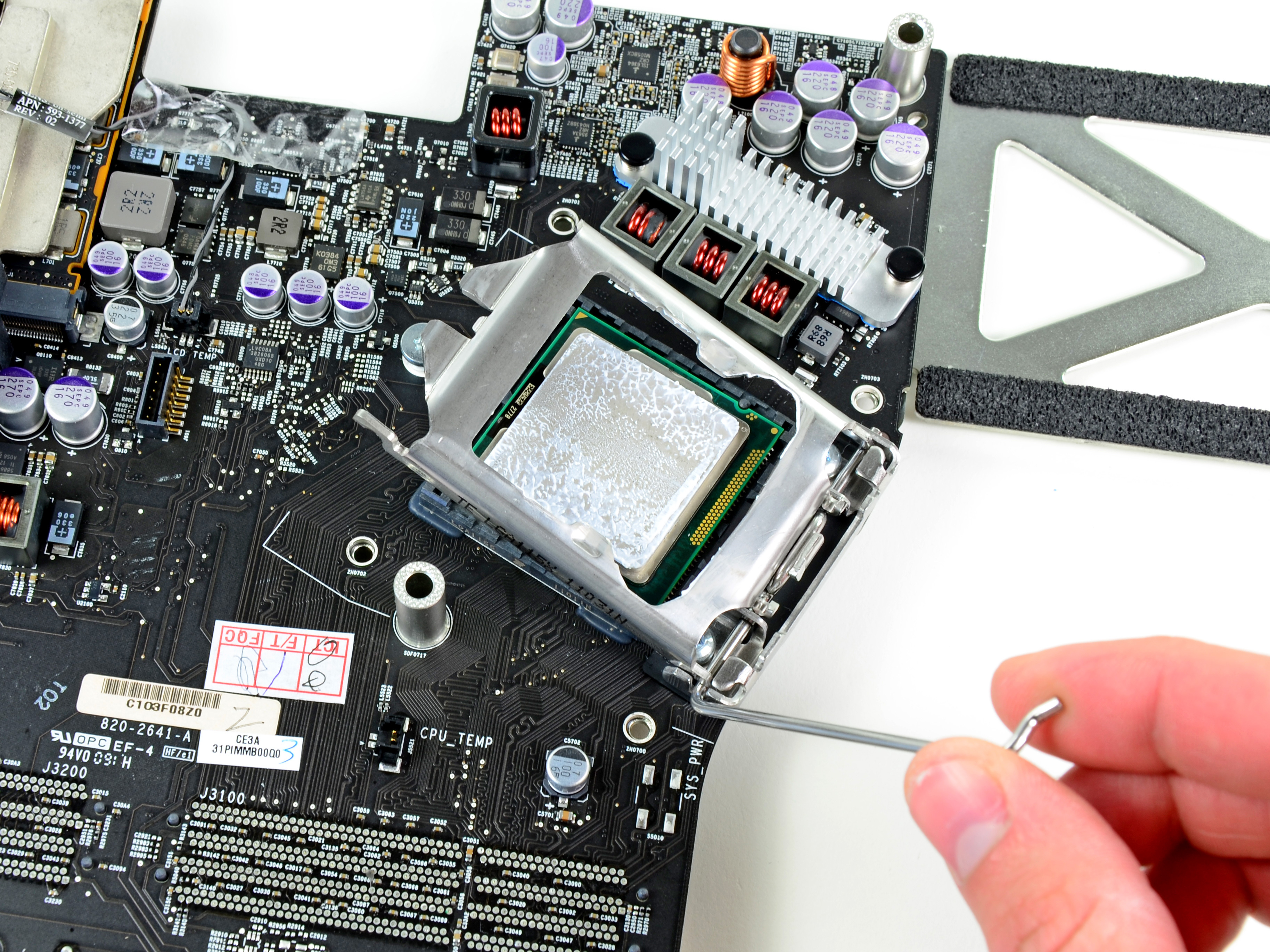

  44. iMac Intel 21.5" EMC 2428 CPU Replacement, CPU Heat Sink: step 44, image 1 of 1
    • Peel the piece of tape covering the heat sink thermal sensor cable up off the logic board.

  49. iMac Intel 21.5" EMC 2428 CPU Replacement, CPU: step 49, image 1 of 2 iMac Intel 21.5" EMC 2428 CPU Replacement, CPU: step 49, image 2 of 2
    • Carefully pull the CPU retaining bar away from the CPU socket.
    • Rotate the bar away from the logic board.
  50. iMac Intel 21.5" EMC 2428 CPU Replacement: step 50, image 1 of 2 iMac Intel 21.5" EMC 2428 CPU Replacement: step 50, image 2 of 2
    • Carefully lift the CPU straight up off its socket.
    • Be sure your new CPU is properly aligned and seated before clamping it back down. The small gold arrow on the CPU should align with the white arrow printed on the logic board near the CPU socket as seen in the second picture.
    • Make sure to apply a new layer of thermal paste before reattaching the heat sink. Our thermal paste guide makes it easy.
