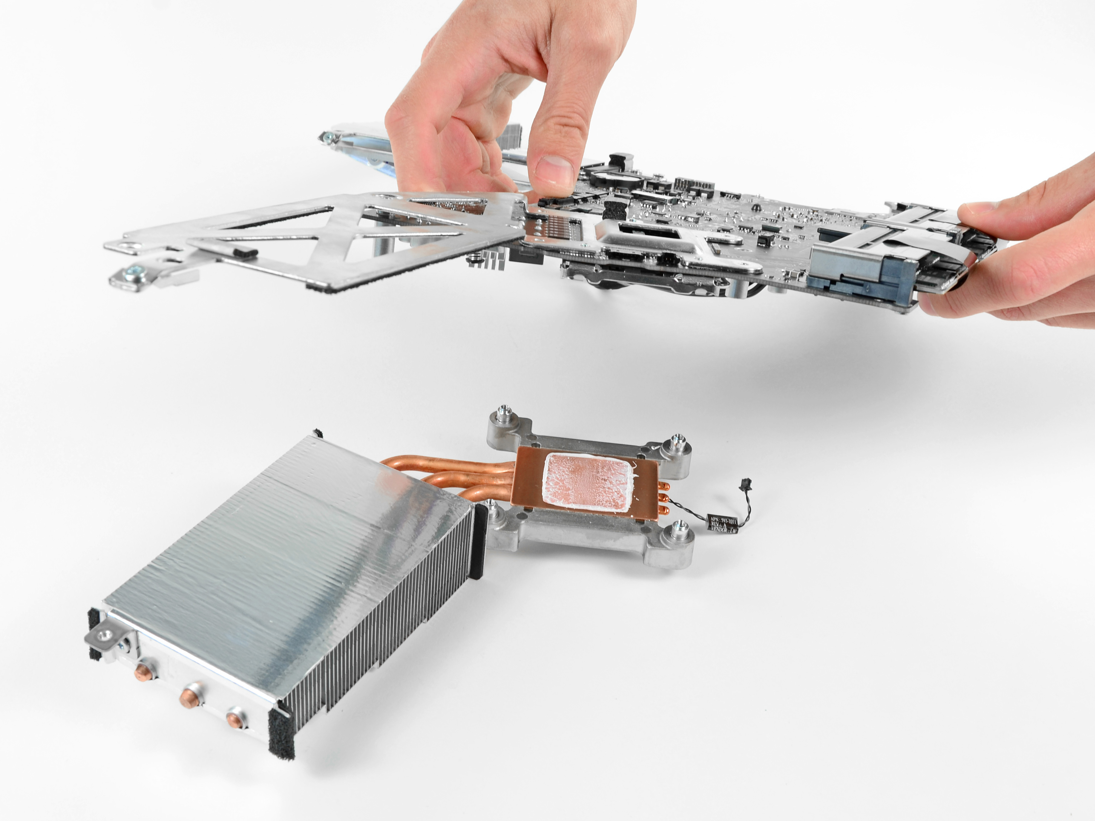

  34. iMac Intel 21.5" EMC 2428 CPU Heat Sink Replacement: step 34, image 1 of 2 iMac Intel 21.5" EMC 2428 CPU Heat Sink Replacement: step 34, image 2 of 2
    • Remove the following four screws:
    • One 9.3 mm T10 coarse-threaded screw
    • One 25 mm T10 coarse-threaded screw
    • Two 22 mm fine-threaded screws
    • Pull the upper right and lower left corners of the power supply away from the rear case to dislodge the mounting posts attached to the power supply's corners.
  35. iMac Intel 21.5" EMC 2428 CPU Heat Sink Replacement: step 35, image 1 of 2 iMac Intel 21.5" EMC 2428 CPU Heat Sink Replacement: step 35, image 2 of 2
    • Carefully lift the power supply out of the outer case and rotate it to expose the cable lock as shown, minding the DC-out and AC-in cables still attaching it to the iMac.
    • Disconnect the DC-out cable by depressing the locking mechanism on the connector while you pull the connector away from its socket on the power supply.
    • Once the locking mechanism has cleared the socket, pull the DC-in connector away from the power supply.
  36. iMac Intel 21.5" EMC 2428 CPU Heat Sink Replacement: step 36, image 1 of 1
    • Disconnect the AC-In cable by depressing the locking mechanism while pulling the connector away from its socket.
    • Remove the power supply from the outer case.
  37. iMac Intel 21.5" EMC 2428 CPU Heat Sink Replacement: step 37, image 1 of 1
    • Remove the plastic wall that is installed directly to the right of the LED driver board.
  38. iMac Intel 21.5" EMC 2428 CPU Heat Sink Replacement: step 38, image 1 of 2 iMac Intel 21.5" EMC 2428 CPU Heat Sink Replacement: step 38, image 2 of 2
    • Slightly pull the logic board away from the back of the outer case, then lift it upward to clear the lower front face of the outer case.
  39. iMac Intel 21.5" EMC 2428 CPU Heat Sink Replacement: step 39, image 1 of 1
    • Disconnect the LCD temperature cable by pulling its connector up and out of its socket on the logic board.
  40. iMac Intel 21.5" EMC 2428 CPU Heat Sink Replacement: step 40, image 1 of 2 iMac Intel 21.5" EMC 2428 CPU Heat Sink Replacement: step 40, image 2 of 2
    • Depress the locking mechanism and carefully pull the DC-In cable out of its socket on the back of the logic board.
  41. iMac Intel 21.5" EMC 2428 CPU Heat Sink Replacement: step 41, image 1 of 1
    • Being careful not to damage the socket on the logic board, gently pull the hard drive SATA data cable straight out of its socket on the logic board.
  42. iMac Intel 21.5" EMC 2428 CPU Heat Sink Replacement: step 42, image 1 of 1
    • Pull the hard drive power cable connector out of its socket on the logic board.
  43. iMac Intel 21.5" EMC 2428 CPU Heat Sink Replacement: step 43, image 1 of 1
    • Remove the logic board from the outer case, minding any cables that may get caught.
    • When reinstalling the logic board, plug in a thunderbolt cable and a USB cable into the USB port closest to the headphone/microphone ports before tightening the logic board screws to ensure proper alignment.

  48. iMac Intel 21.5" EMC 2428 CPU Heat Sink Replacement: step 48, image 1 of 1
    • Carefully lift the logic board off the heat sink.
    • If the two components appear stuck together, carefully pry them apart with the flat end of a spudger, being careful not to disturb any surface-mount components on the logic board.
    • Make sure to apply a new layer of thermal paste before reattaching the heat sink. Our thermal paste guide makes it easy.
