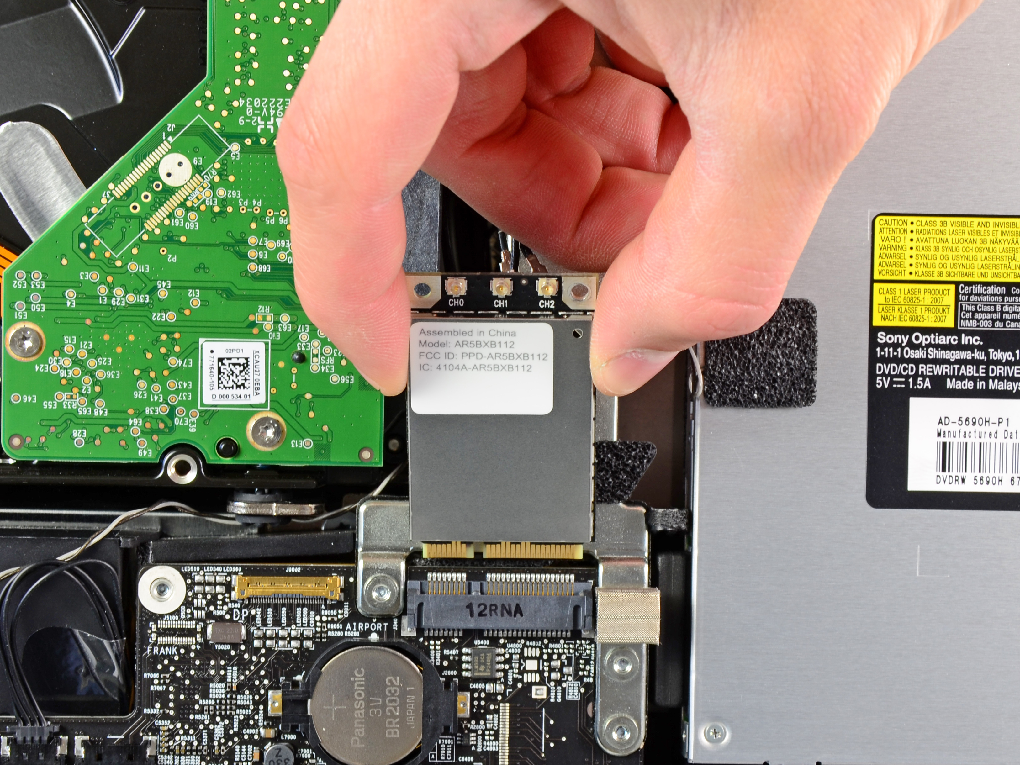

  10. iMac Intel 21.5" EMC 2428 AirPort Card Replacement, AirPort Card: step 10, image 1 of 2 iMac Intel 21.5" EMC 2428 AirPort Card Replacement, AirPort Card: step 10, image 2 of 2
    • Use the flat end of a spudger to pry all three AirPort antenna cable connectors up from their sockets on the AirPort card.
    • During reinstallation, connect the cable with no stripes to the socket marked CH0, the cable with one stripe to CH1, and the cable with two stripes to CH2.
  11. iMac Intel 21.5" EMC 2428 AirPort Card Replacement: step 11, image 1 of 1
    • Remove the single 5.3 mm T6 Torx screw securing the AirPort card to its socket.
  12. iMac Intel 21.5" EMC 2428 AirPort Card Replacement: step 12, image 1 of 1
    • Pull the AirPort card away from its socket and remove it from the iMac.
