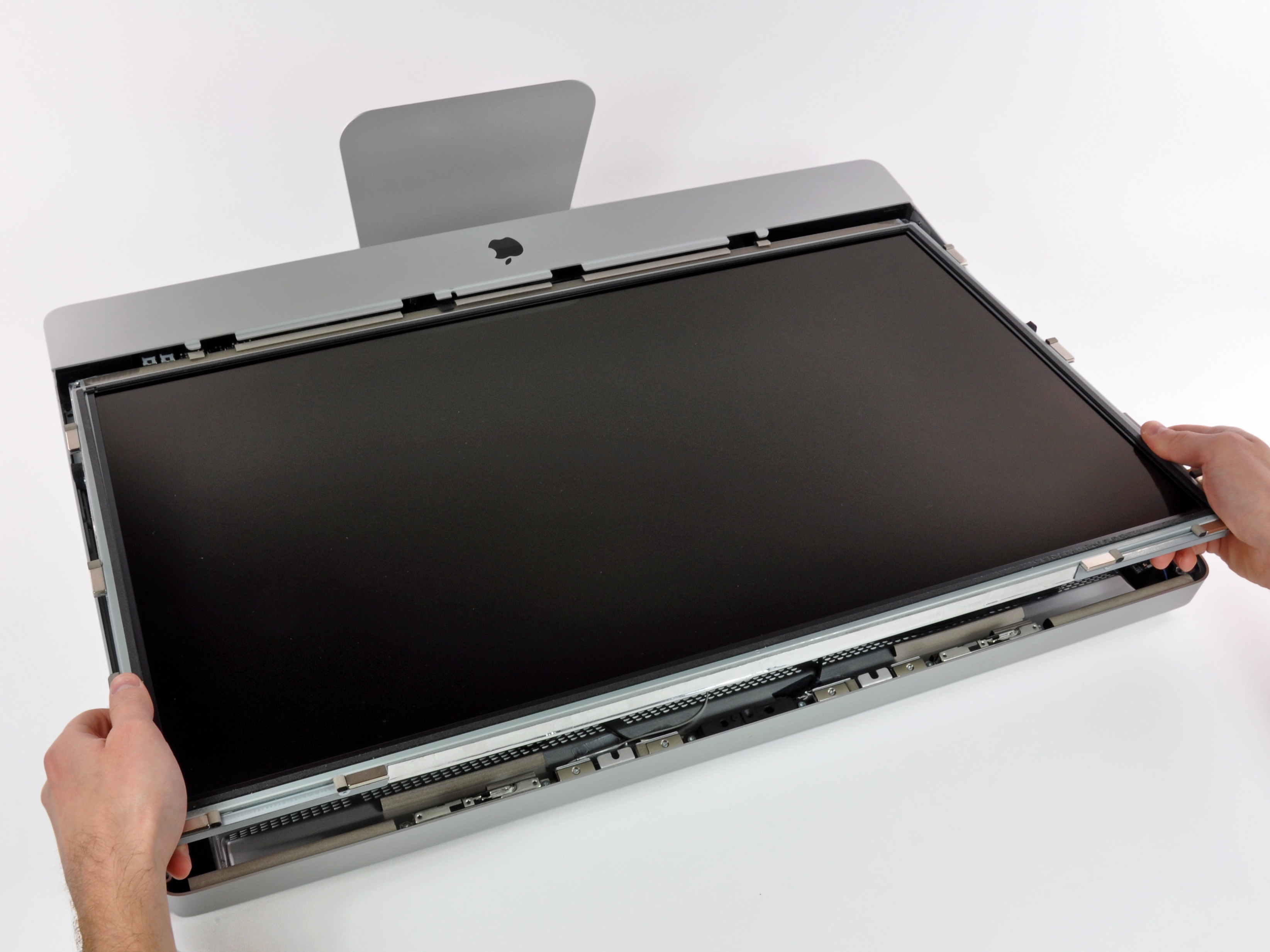

  3. iMac Intel 21.5" EMC 2389 Display Replacement, Display: step 3, image 1 of 3 iMac Intel 21.5" EMC 2389 Display Replacement, Display: step 3, image 2 of 3 iMac Intel 21.5" EMC 2389 Display Replacement, Display: step 3, image 3 of 3
    • Remove the eight 8 mm T10 Torx screws securing the display to the outer case.
    • The last two pictures are detail shots of each side of the display.
  4. iMac Intel 21.5" EMC 2389 Display Replacement: step 4, image 1 of 1
    • Slightly lift the top edge of the display out of the outer case.
    • Do not lift it too much. There are several cables attaching the display to the logic board.

  9. iMac Intel 21.5" EMC 2389 Display Replacement: step 9, image 1 of 1
    • Carefully pull the display toward the top edge of your iMac and lift it out of the outer case, minding any cables that may get caught.
