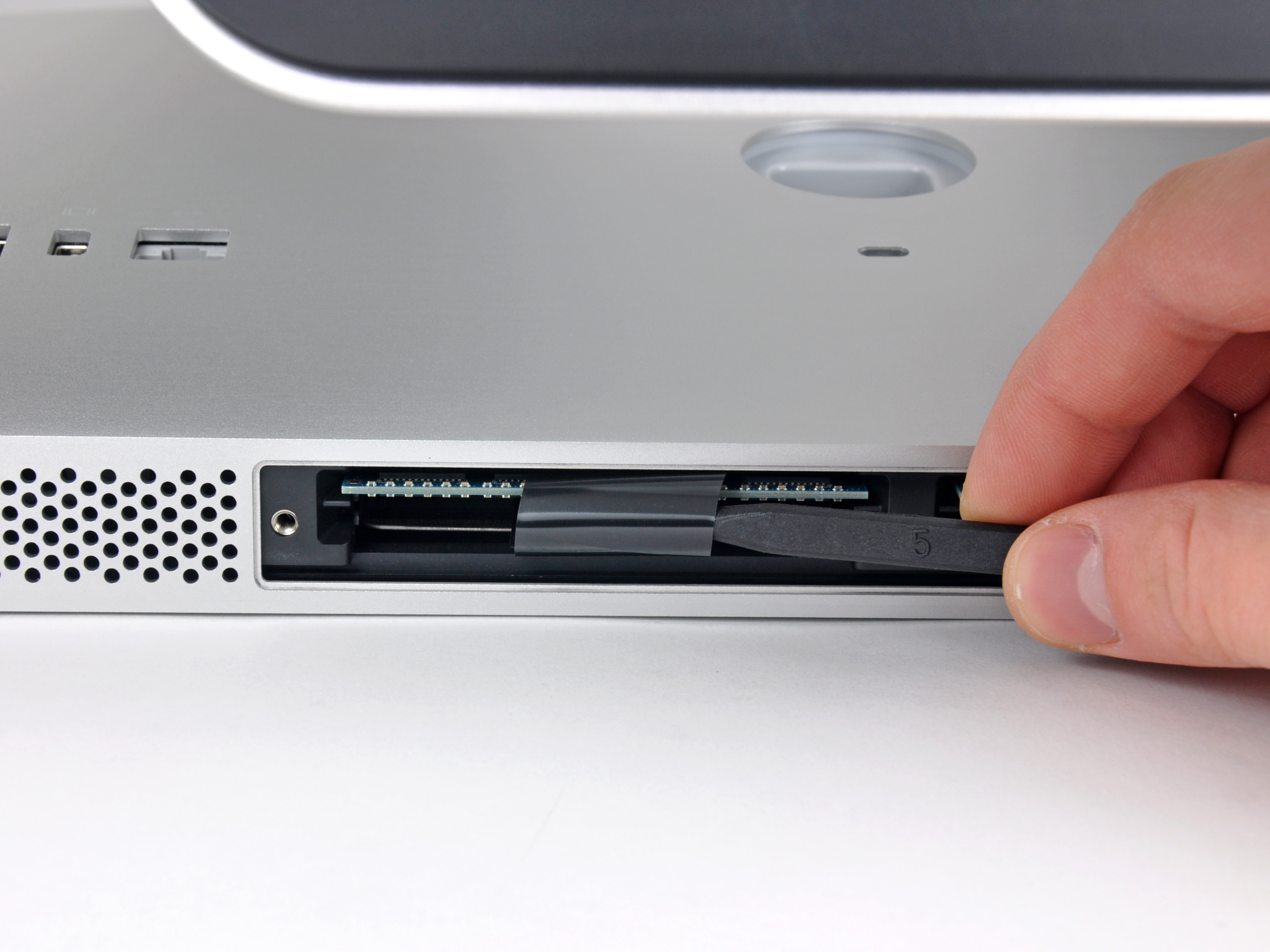

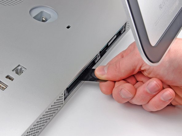

Add Note Edit Step 2 — RAM  ¶
  • Use the sharp tip of a spudger to pull the black plastic RAM tabs out of the memory bay.

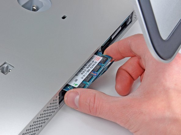

Add Note Edit Step 3  ¶
  • Pull the black plastic RAM tab away from your iMac to eject the RAM chip.
  • Grab the RAM chip by its edges and pull it straight out of its slot.
  • If two RAM chips are installed, repeat this process for the other chip.
