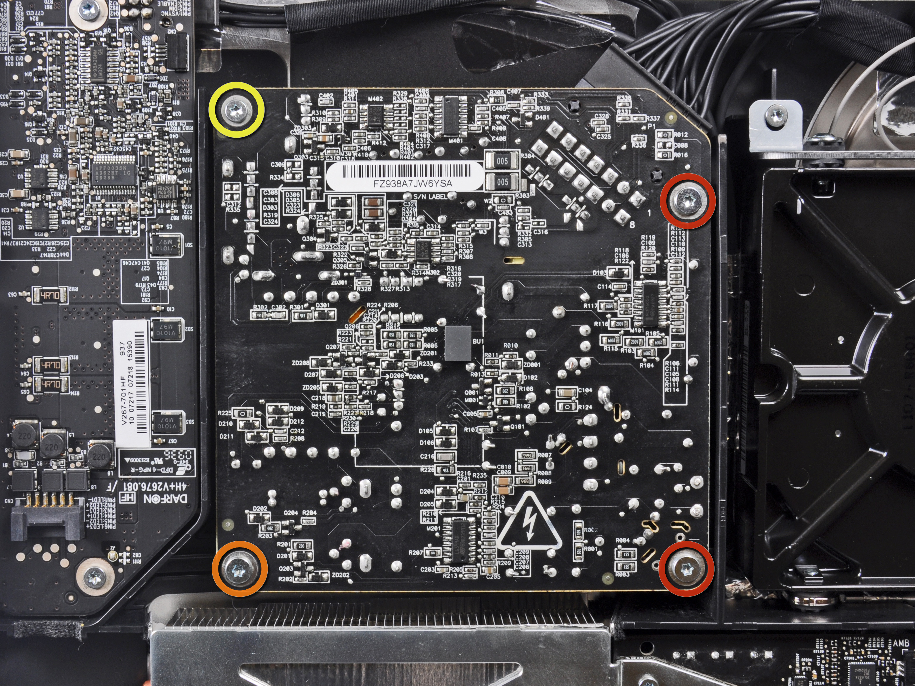

  10. iMac Intel 21.5" EMC 2308 Power Supply Replacement, Power Supply: step 10, image 1 of 1
    • Remove the following four screws securing the power supply to the outer case:
    • Two 22.2 mm fine-thread T10 Torx
    • One 25 mm coarse-thread T10 Torx
    • One 9 mm coarse-thread T10 Torx
    • The next few steps bring your hands close to the exposed face of the power supply. To avoid a high voltage shock from the many large capacitors attached to the board, do not touch the face of the power supply.
  11. iMac Intel 21.5" EMC 2308 Power Supply Replacement: step 11, image 1 of 1
    • Carefully lift the power supply out of the outer case and rotate it to expose the cable lock as shown, minding the DC-Out cable still attaching it to the iMac.
    • Disconnect the DC-In cable by depressing the locking mechanism on the connector while you pull the connector away from its socket on the power supply.
    • Once the locking mechanism has cleared the socket, pull the DC-In connector away from the power supply.

The Photo shows the hand right on th back of the board, which seems more than a bit dangerous. I would touch the board only at its corners therefore.
Chris Müller - Reply
