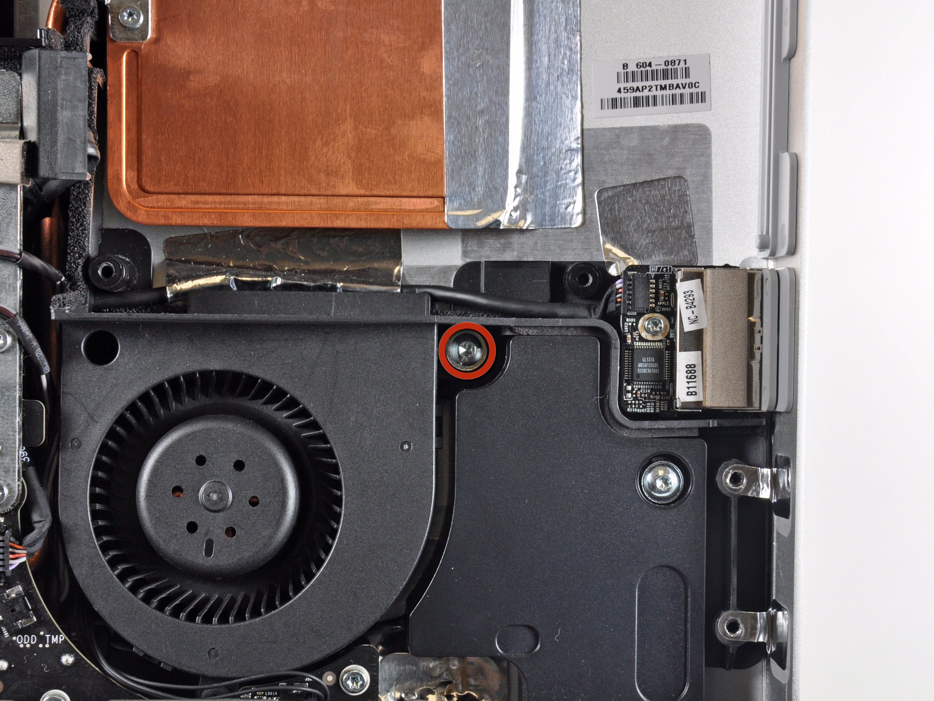

  • Remove the eight 8 mm T10 Torx screws securing the display to the outer case.
  • The last two pictures are detail shots of each side of the display.

  • Slightly lift the top edge of the display out of the outer case.
  • Do not lift it too much. There are several cables attaching the display to the logic board.
