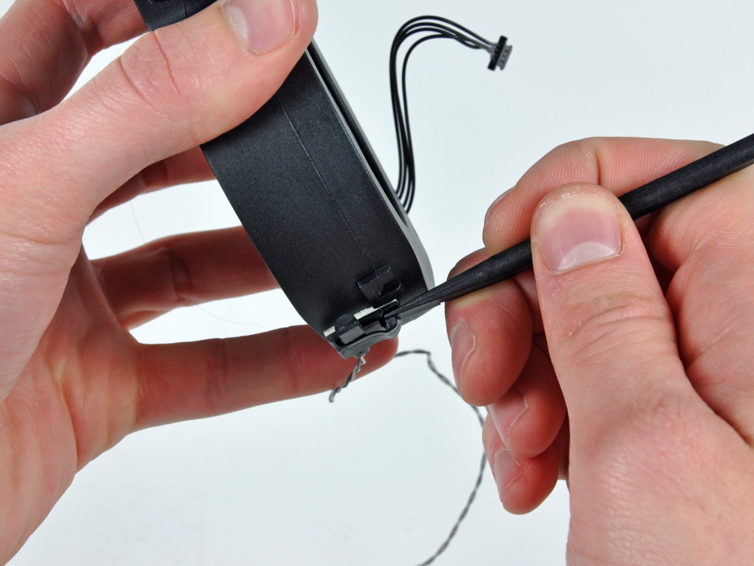

  • Pull the vertical sync ribbon cable out of its socket on the LED driver board near the top left corner of your iMac.
  • The vertical sync ribbon cable has a ZIF style end, but the socket has no lock or retaining flap. Simply pull the cable away from its socket toward the optical drive side of the iMac to disconnect it from the LED driver board.
Image #1 Image #2 Image #3
Add Note Edit Step 7  ¶
  • Rotate the display out of the outer case enough to disconnect the LED backlight power cable from the LED driver board.
  • Disconnect the LED backlight power cable by depressing the locking mechanism while pulling the connector away from its socket (toward the bottom edge of the iMac).
Image #1
Add Note Edit Step 8  ¶
  • Squeeze the two display data cable connector arms together to unlock it from its socket on the logic board.
  • Pull the display data cable connector away from its socket on the logic board.
