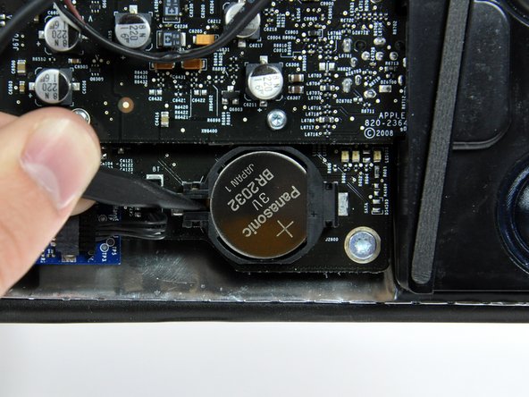

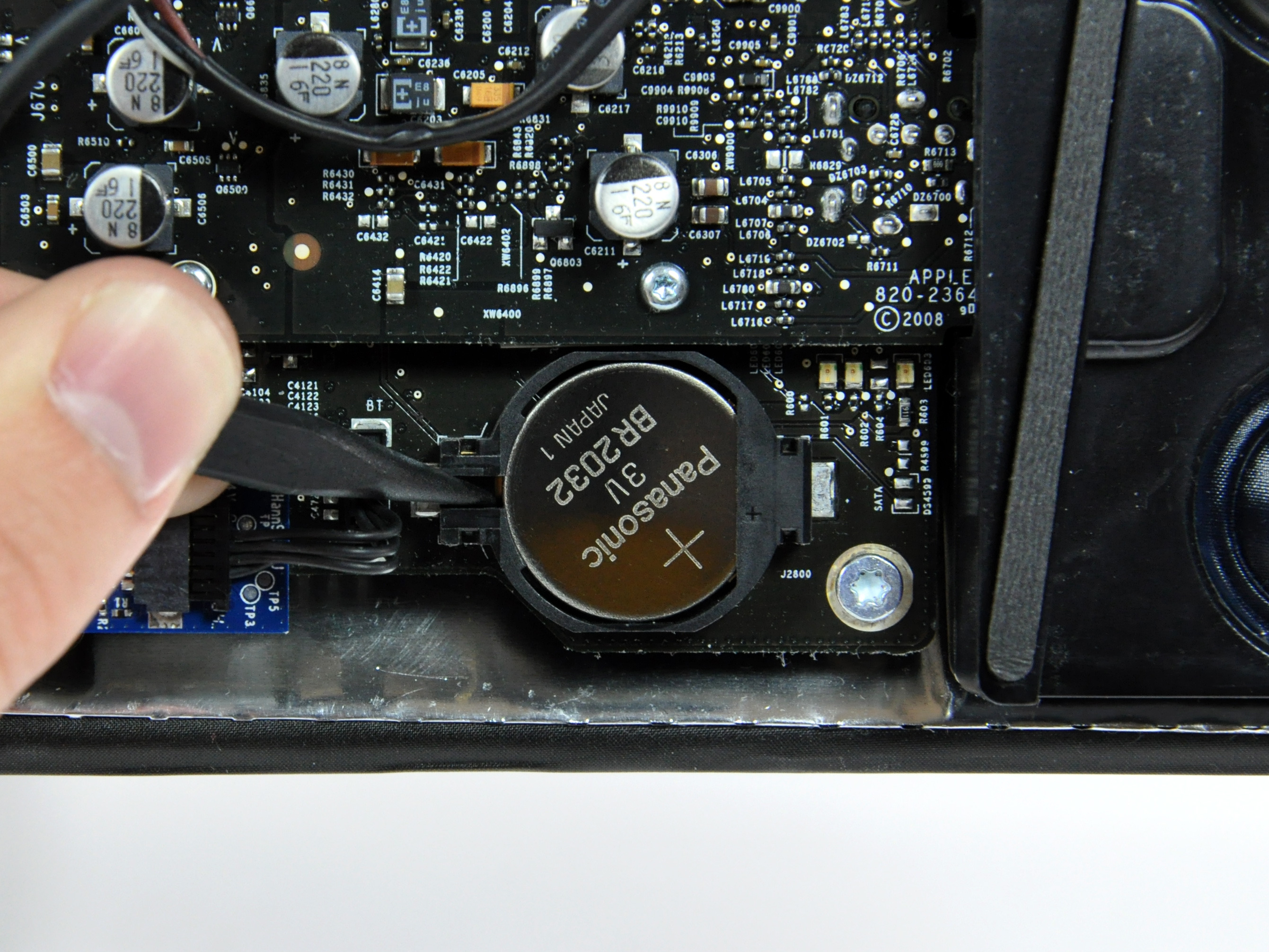

Add Note Edit Step 7 — PRAM Battery  ¶
  • Use the tip of a spudger to pry the PRAM battery out of its holder.
