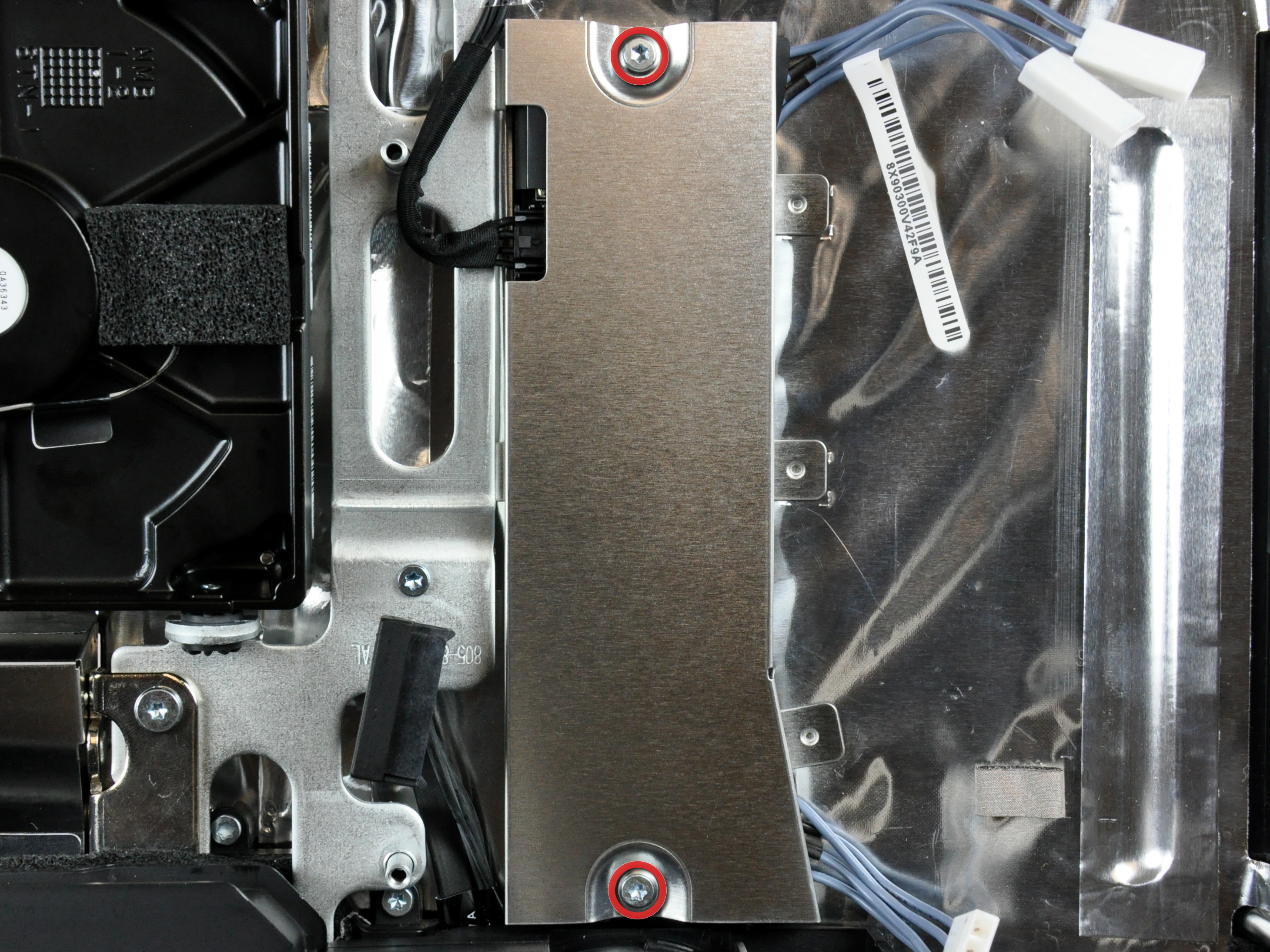

Installing iMac Intel 20" EMC 2266 Inverter
- Author: Walter Galan
- Difficulty: Moderate
Use this guide to replace your inverter.
Sections
- Access Door 1 step
- Glass Panel 2 steps
- Front Bezel 3 steps
- Display Panel 4 steps
- Optical Drive 6 steps
- Inverter 4 steps
