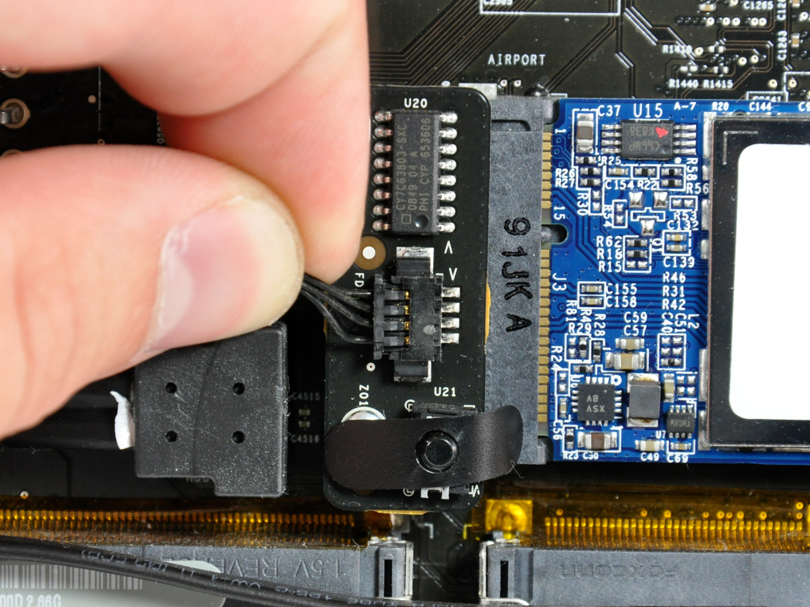

Add Note Edit Step 7 — IR Board  ¶
  • Disconnect the IR sensor cable from the IR board by pulling its connector away from the socket on the IR board.
  • Pull the connector parallel to the face of the logic board.
Image #1

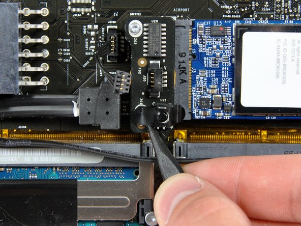

Add Note Edit Step 8  ¶
  • If necessary, use a spudger to pry up the left edge of the black tape covering the IR sensor to reveal the screw hidden underneath.
  • Don't completely remove this piece of tape.
  • During reassembly, remember to stick this piece of tape back down as it was before disassembly.
