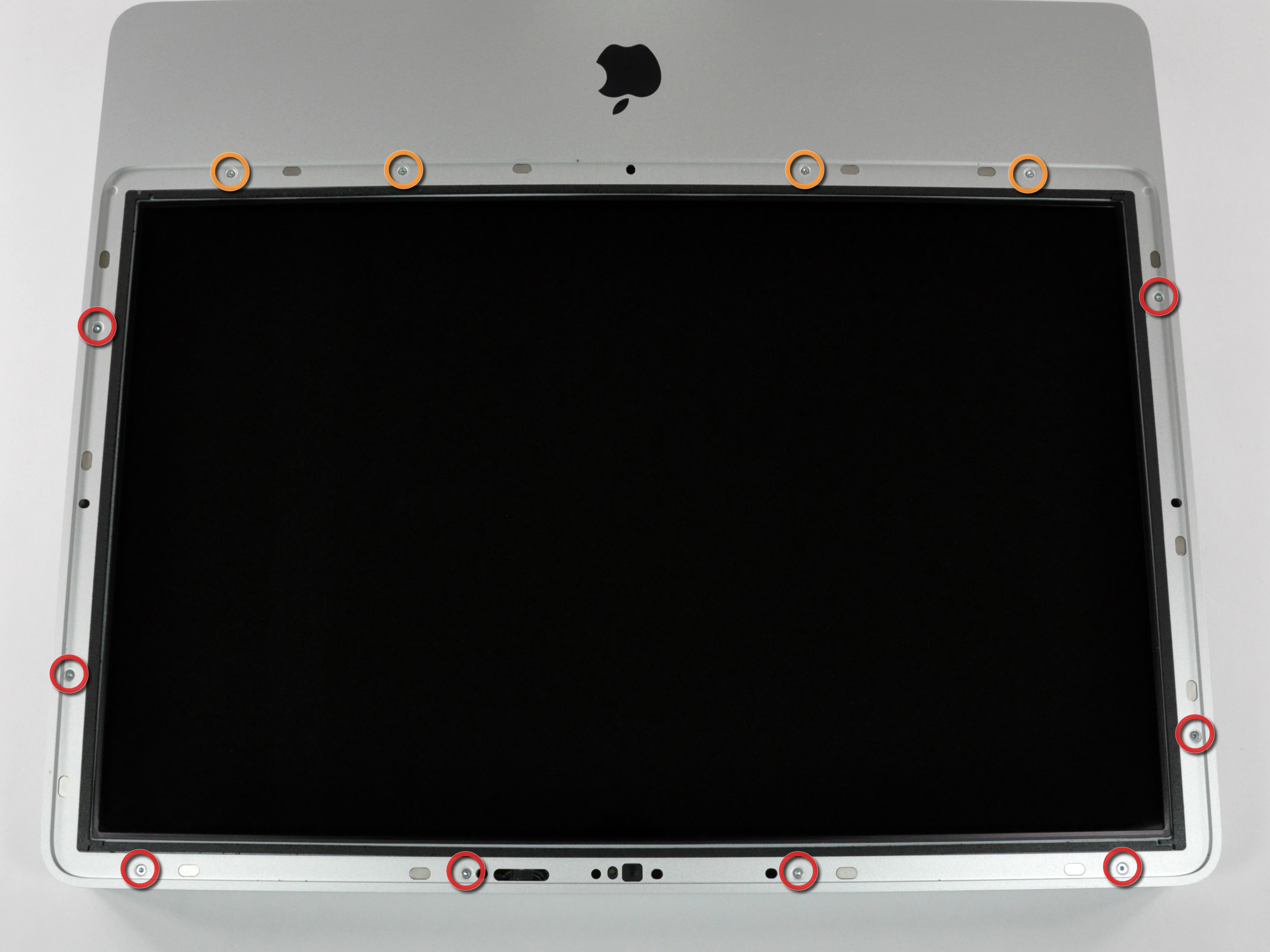

Add Note Edit Step 4 — Front Bezel  ¶
  • Remove the following 12 screws securing the front bezel to the rear case:
    • Eight 13 mm T8 Torx.
    • Four 25 mm T8 Torx.
  • On the 24" iMac Intel Model A1225, the bottom center two screws are long (26mm), four on sides (two left, two right) are medium (18mm), and the remaining 6 (four top, two bottom corners) are short (14mm).
Image #1 Image #2
