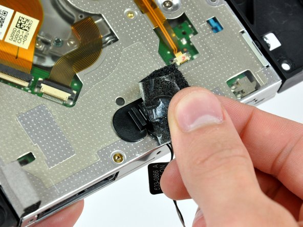

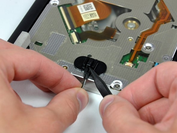

Add Note Edit Step 17 — Optical Drive Replacement  ¶
  • Remove the piece of foam tape covering the optical drive thermal sensor.
Image #1
Add Note Edit Step 18  ¶
  • To remove the optical drive thermal sensor, use the tip of a spudger to lift the center finger of the thermal sensor bracket while applying slight tension to the thermal sensor cable.
  • If the thermal sensor is stuck to the optical drive, skip to the next step.
Image #1

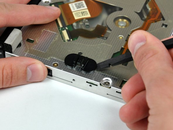

Add Note Edit Step 19  ¶
  • Use the flat end of a spudger to pry the optical drive thermal sensor bracket up off the adhesive securing it to the optical drive.
  • If the adhesive gets dirty or will not stick to your new optical drive, place some double-sided tape under the two semicircular ears of the thermal sensor bracket.
Image #1

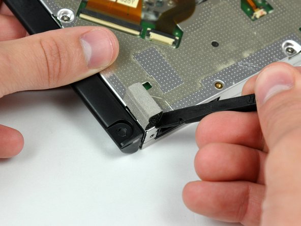

Add Note Edit Step 20  ¶
  • Use a spudger to remove the small piece of EMI foam from the bottom of the optical drive.
  • Don't forget to transfer this to your new drive.

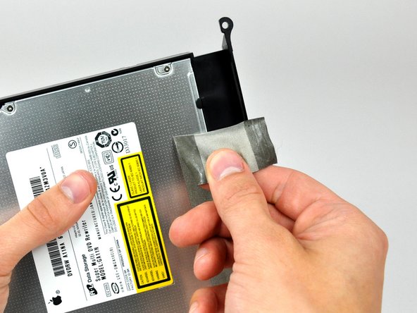

Image #1
Add Note Edit Step 21  ¶
  • Peel the EMI tape off the optical drive.
  • Don't forget to transfer this to your new optical drive.

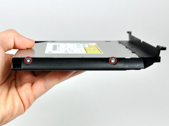

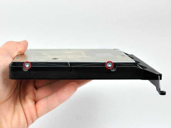

Image #1 Image #2
Add Note Edit Step 22  ¶
  • Remove the two T10 Torx screws from both sides of the optical drive (four screws total).

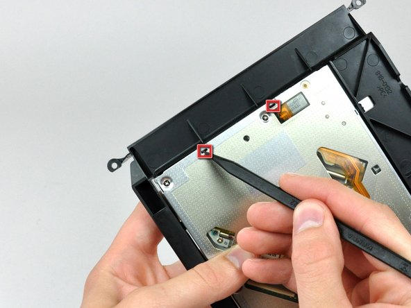

Image #1

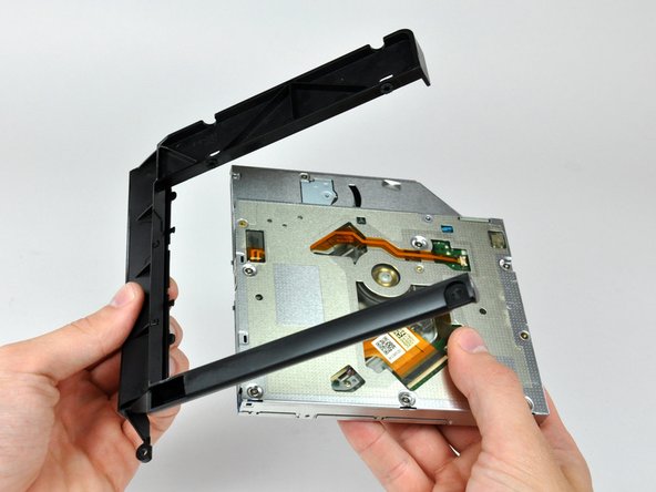

Add Note Edit Step 23  ¶
  • Use the tip of a spudger to press each of the optical drive bracket tabs out of their slots on the bottom of the optical drive.

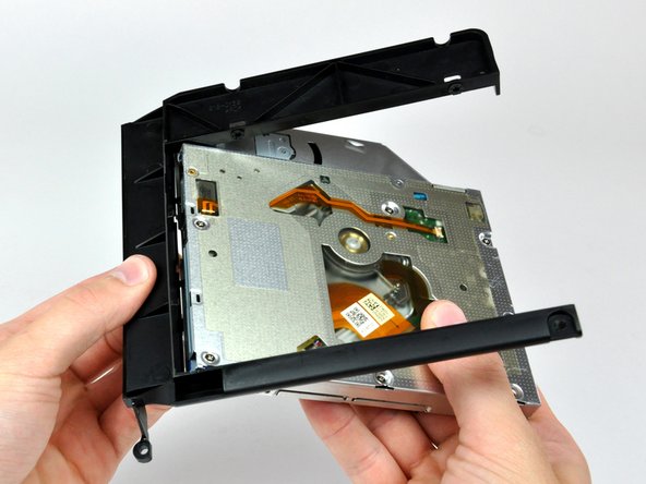

Image #1 Image #2
Add Note Edit Step 24  ¶
  • Rotate the optical drive bracket slightly away from the optical drive.
  • Pull the optical drive bracket away from the open end of the optical drive, minding any tabs that may get caught.
  • If you have a disk or anything else stuck inside your optical drive, we have a guide to fix it.
