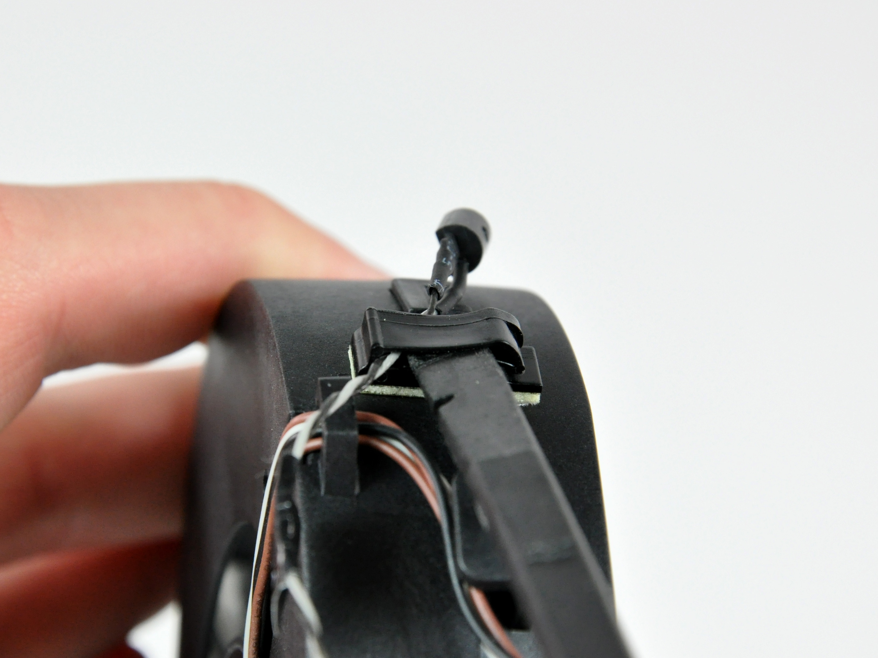

Add Note Edit Step 7 — Display Panel  ¶
  • Pull the LCD temperature sensor connector straight up off its socket on the logic board.
  • (located at the top of the logic board on the 24")
Image #1 Image #2
Add Note Edit Step 8  ¶
  • Remove the two T6 Torx screws securing the display data cable to the logic board.
  • Use the attached black tab to pull the display data cable connector straight away from the logic board.
