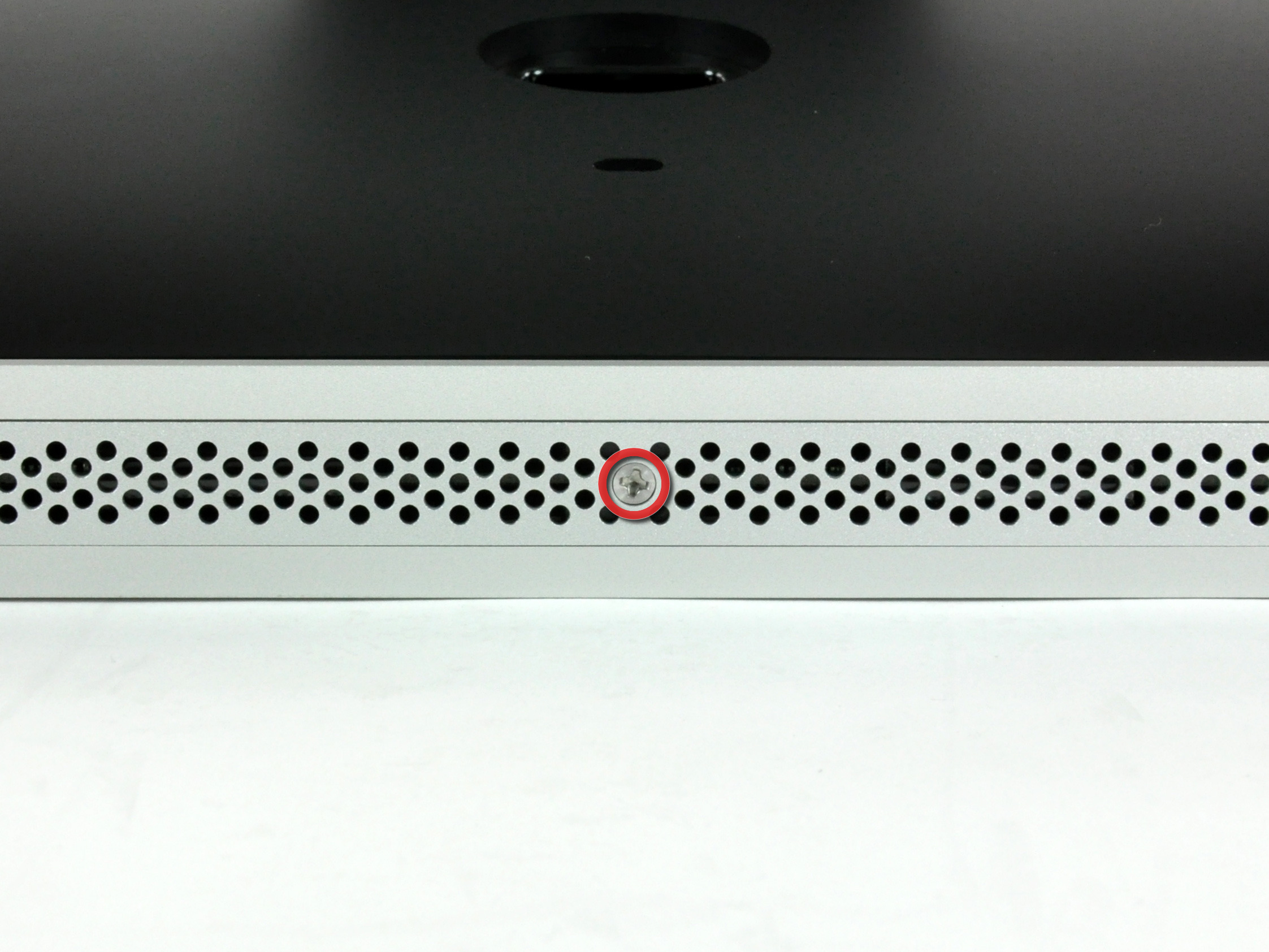

Remove your access door to replace RAM chips or to open the case of your iMac.
first image
Add Note Edit Step 1 — Access Door  ¶
  • Lay your iMac front side down on a table with the lower edge facing yourself.
  • Loosen the single Phillips screw in the center of the access door.
  • This screw is captive in the access door.
  • Remove the access door from your iMac.
