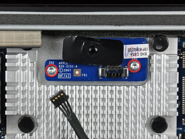

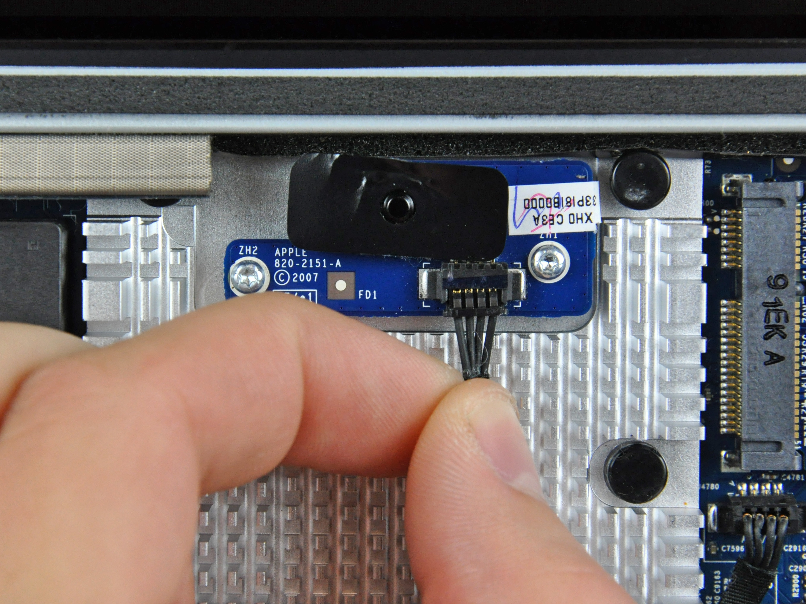

Add Note Edit Step 7 — IR Board  ¶
  • Disconnect the IR sensor cable from the IR board by pulling its connector toward the bottom edge of your iMac.
Image #1
Add Note Edit Step 8  ¶
  • Remove the two 5.4 mm T6 Torx screws securing the IR board to the logic board.
  • The IR board is now completely free from the logic board and may fall.
