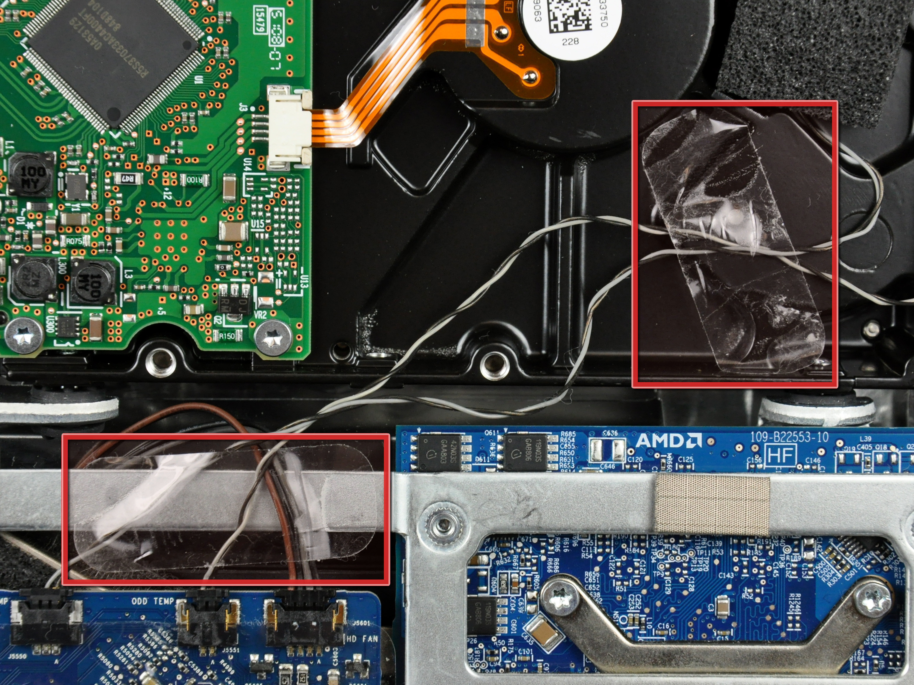

  • If necessary, remove the pieces of tape securing the hard drive/optical drive thermal sensor cables to your iMac.

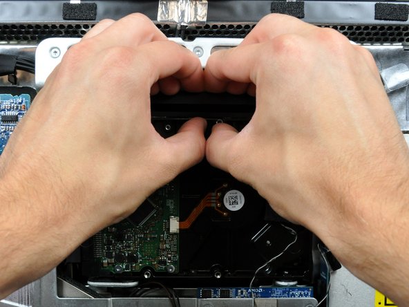

Add Note Edit Step 3  ¶
  • Pressing the top of the hard drive bracket down to release it from the rear case requires a substantial amount of force. We recommend laying your iMac stand-side down on a table to avoid knocking it over.
  • Press the hard drive bracket down toward the bottom edge of your iMac to free it from the rear case, then rotate the top of the drive toward yourself.

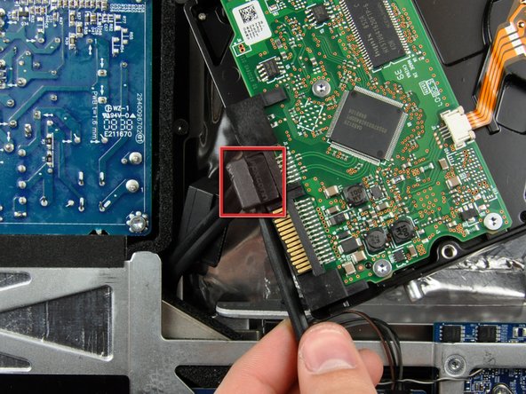

Add Note Edit Step 5  ¶
  • Insert the flat end of a spudger between the SATA power cable connector and the edge of the hard drive.
  • Twist the spudger to separate the connector from the hard drive.
Image #1
Add Note Edit Step 6  ¶
  • Pull the SATA power connector away from the hard drive.
Image #1

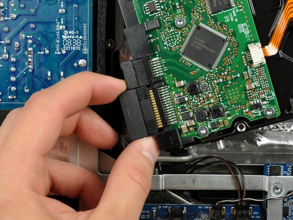

Add Note Edit Step 7  ¶
  • Disconnect the SATA data cable by pulling its connector away from the hard drive.
