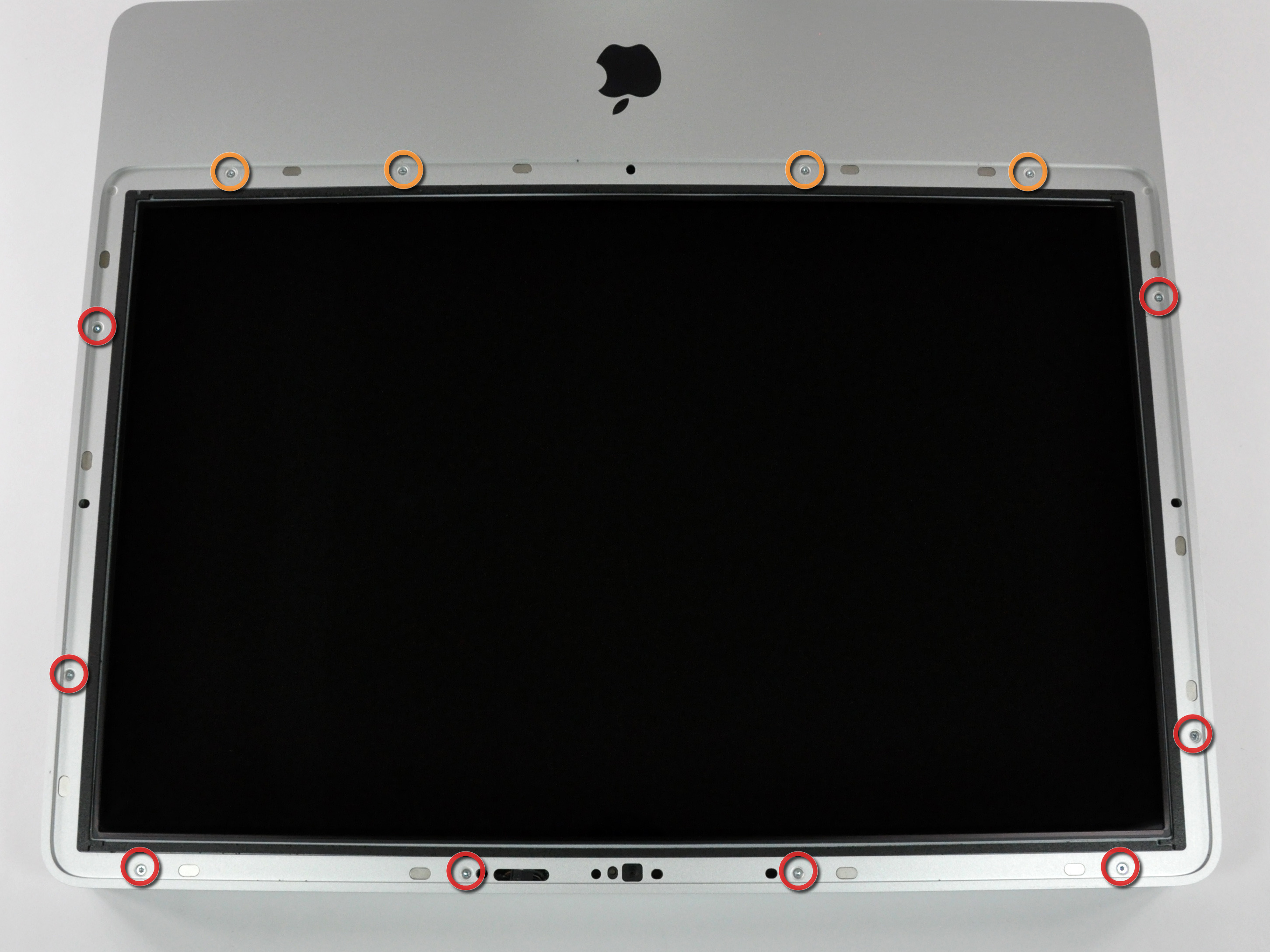

Add Note Edit Step 4 — Front Bezel  ¶
  • Remove the following 12 screws securing the front bezel to the rear case:
    • Eight 13 mm T8 Torx.
    • Four 25 mm T8 Torx.
Image #1 Image #2
Add Note Edit Step 5  ¶
  • The front bezel is still attached to the iMac by the microphone cable.
  • Gently lift the front bezel from its top edge off the rear case. It helps to use your thumbs to push down very gently on the corners of the display.
  • Once the top edge of the front bezel has cleared the rear case, rotate the front bezel toward the stand and lift it off the rear case.
  • When reinstalling the front bezel, start at the lower edge and make sure it is flush with the rear case before lowering the top edge onto the iMac.
