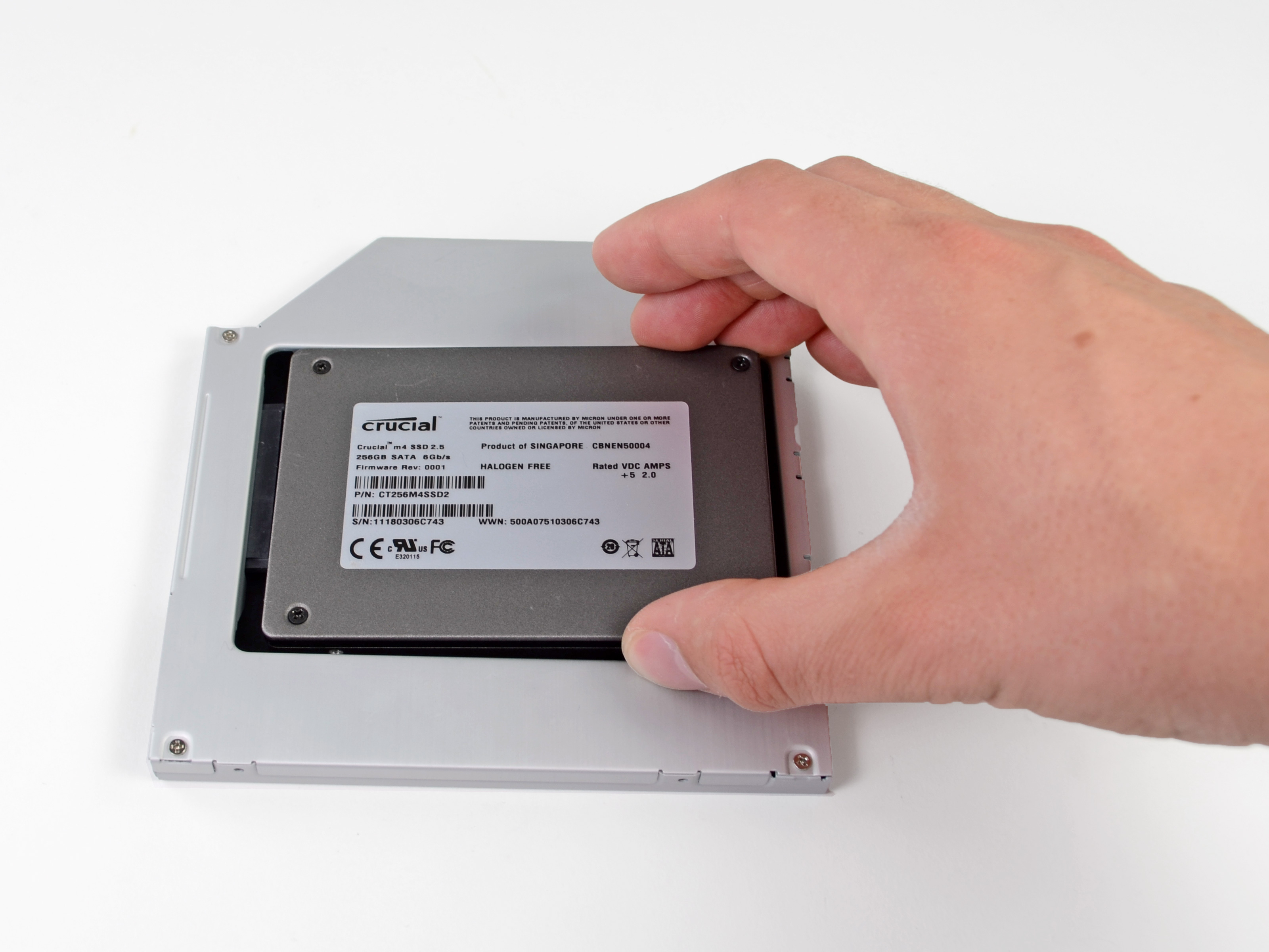

Trade your optical drive for a second hard drive.
  • Add Note x
  • x 9
There are many benefits to adding a second hard drive to your iMac such as improved speeds, greater storage space, and less heartache when installing new software. Use this guide to install one using our optical bay hard drive enclosure.
