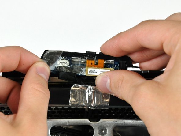

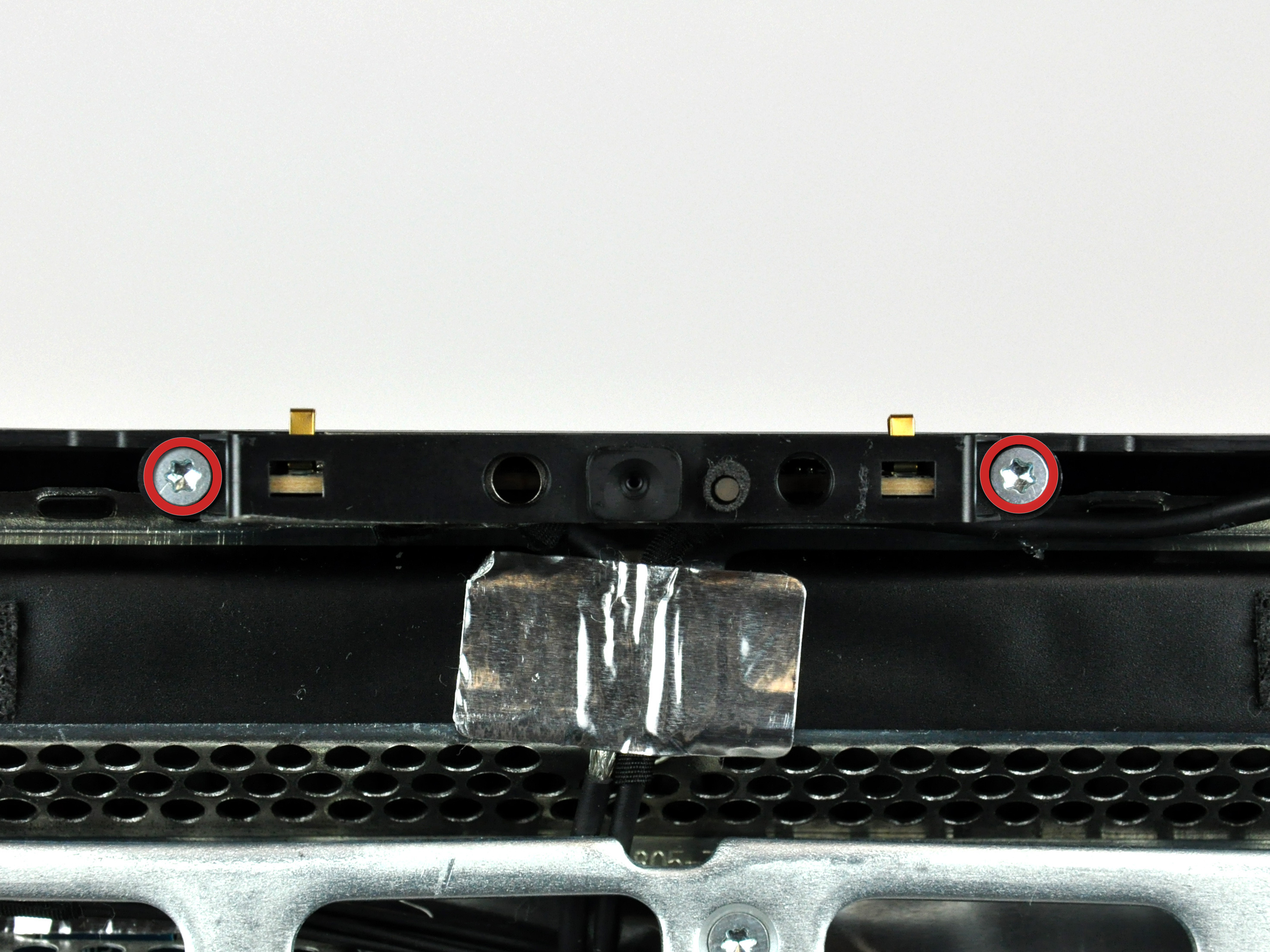

Add Note Edit Step 7 — Camera Board  ¶
  • Remove the two 9 mm T8 Torx screws securing the camera board to the rear case.
Image #1
Add Note Edit Step 8  ¶
  • Slightly lift the camera board out of the rear case.
  • If necessary, remove the piece of tape covering the camera cable connector.
