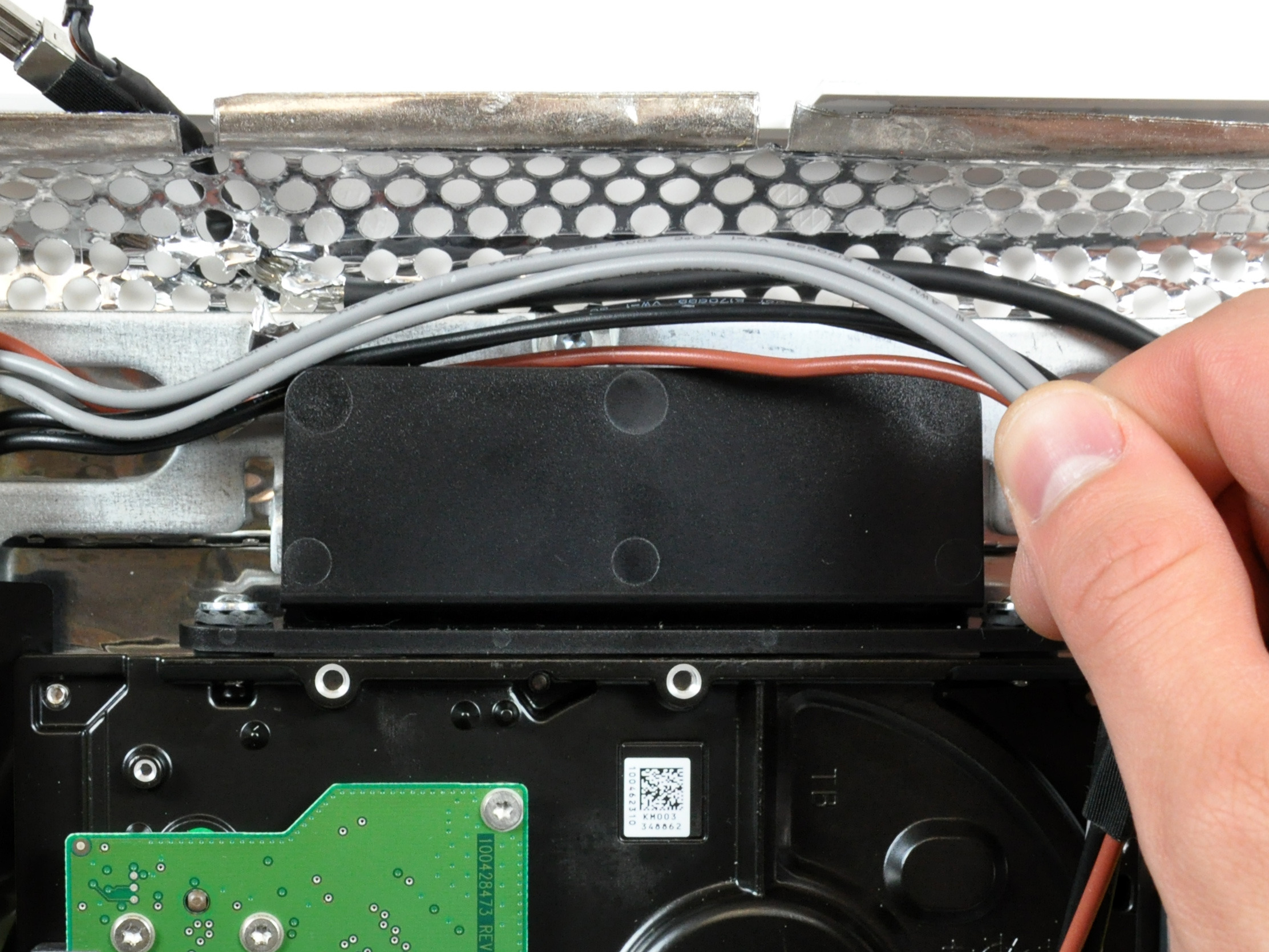

  • De-route the bundle of power supply cables from behind the hard drive bracket.
