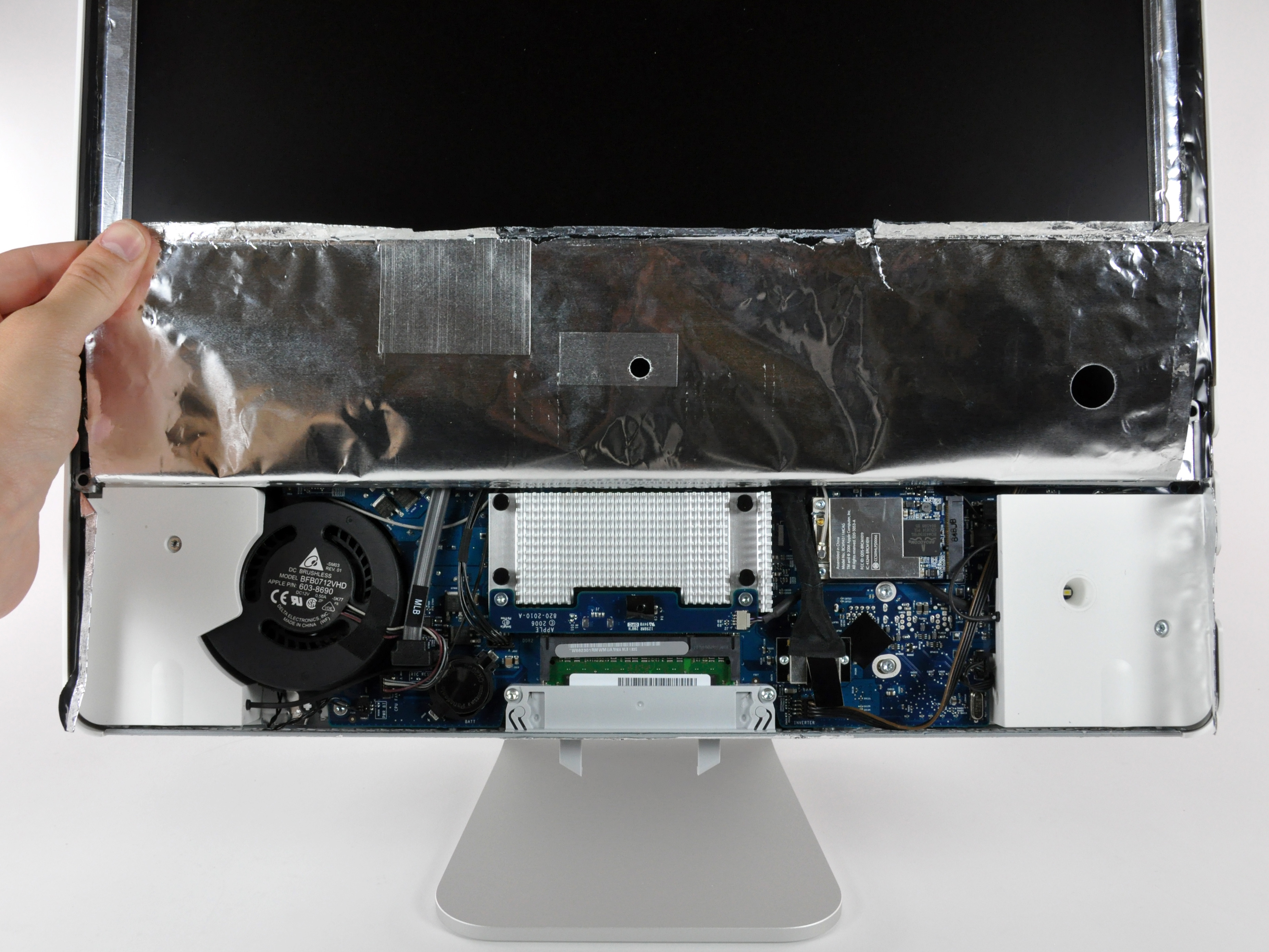

  • Peel back the aluminum EMI tape from the two vertical edges of the display.
  • During reassembly, it is helpful to use several small strips of tape to hold the EMI shielding along the left and right edges of the display footprint out of the way before lowering the display into the rear case of your iMac.
