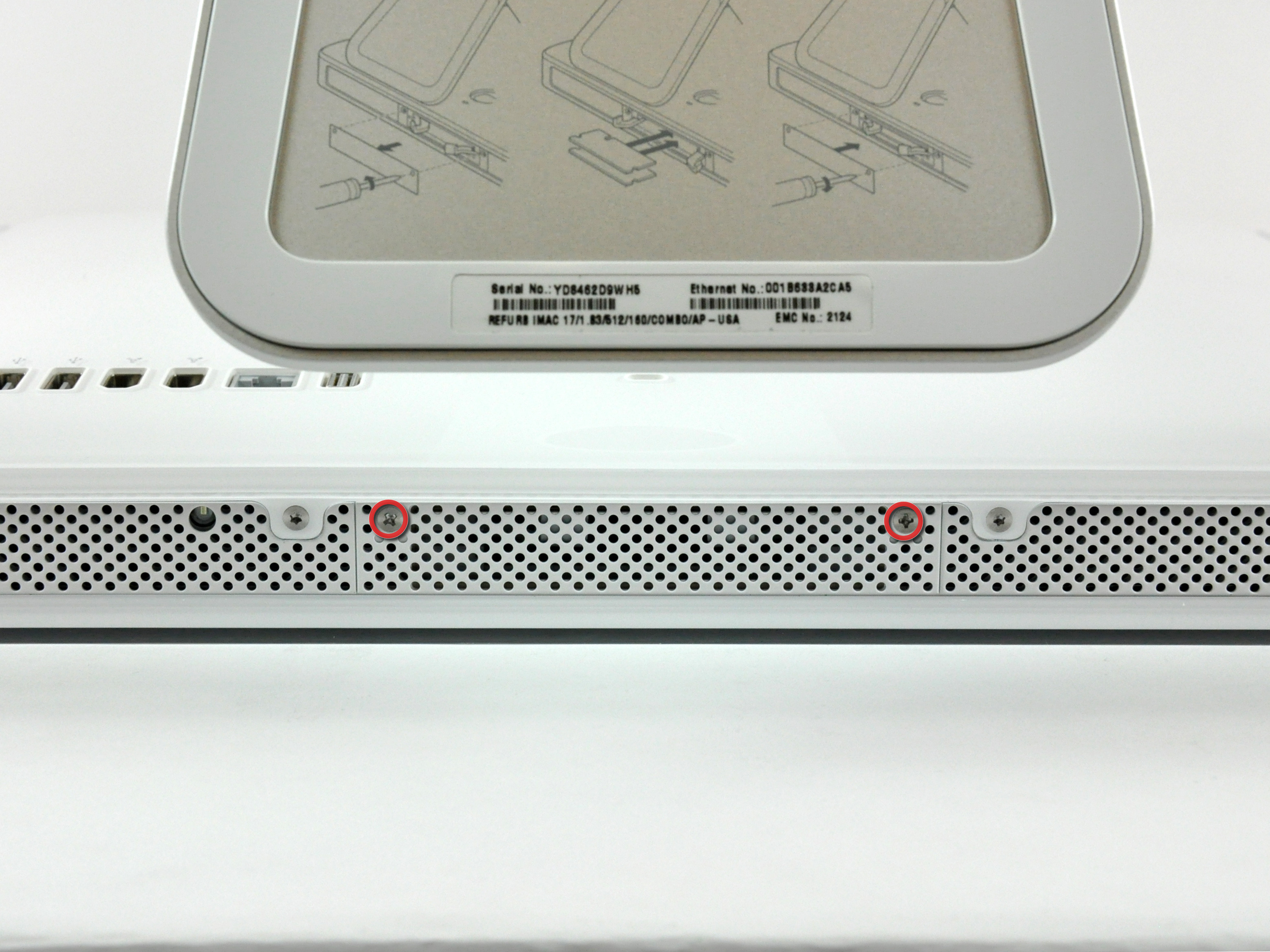

Remove the access door to replace RAM chips and remove your front bezel.
Image #1 Image #2
Add Note Edit Step 1 — Access Door  ¶
  • Loosen the two captive Phillips screws securing the access door to the iMac.
  • Remove the access door from the iMac.
