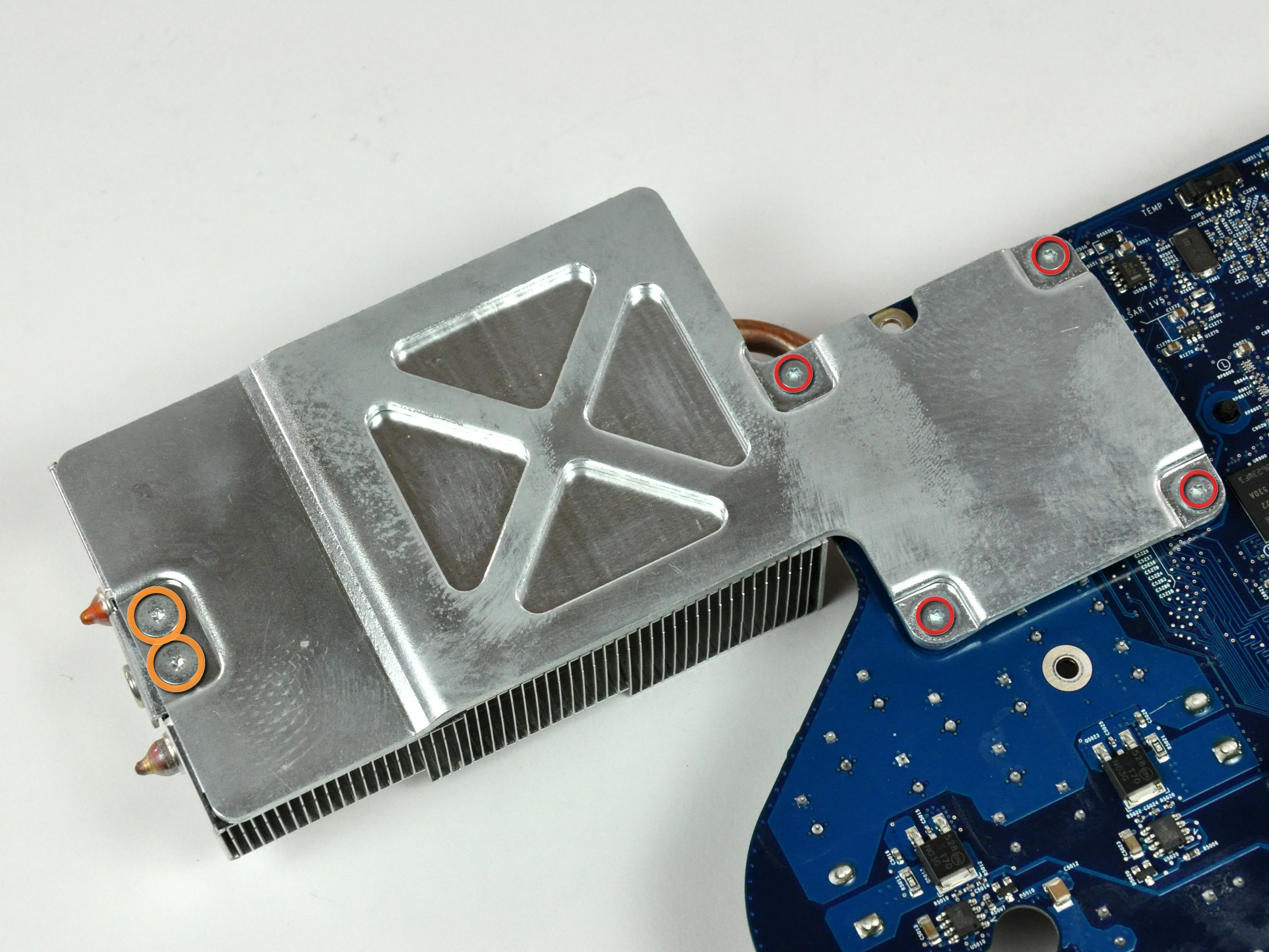

Installing iMac G5 17" Model A1144 Heat Sink
Use this guide to remove your heat sink.
Image #1
Add Note Edit Step 1 — Access Door  ¶
  • Loosen the two Phillips screws securing the access door to your iMac.
  • These screws are captive in the access door.
Image #1
Add Note Edit Step 2  ¶
  • Remove the access door from your iMac.
Image #1
Add Note Edit Step 3 — Front Bezel  ¶
  • Remove the three T8 Torx screws securing the front bezel to the rear panel.
Image #1 Image #2
Add Note Edit Step 4  ¶
  • Orient the iMac face-up, on its backside.
  • Use your thumbs to press both RAM arms in past the front bezel for enough clearance to lift it off the rear case.
Image #1
Add Note Edit Step 5  ¶
  • While holding the RAM arms in with your thumbs, lift the lower edge of the front bezel enough to clear the rear case.
Image #1 Image #2 Image #3
Add Note Edit Step 6  ¶
  • Re-orient your iMac so it sits upright on the stand.
  • Insert a plastic card up into the corner of the air vent slot at the top of the rear case.
  • Push the card toward the top of the iMac to release the front bezel latch.
  • Pull the front bezel away from the rear case.
  • Repeat this process for the other side of the front bezel.
  • It may be necessary to apply several layers of duct tape to the top of the access card to aid in releasing the latches.
  • If the bezel refuses to release, try pressing the lower edge back onto the rear case and repeat this opening process.
Image #1
Add Note Edit Step 7  ¶
  • Lay your iMac stand-side down on a table.
  • Lift the front bezel from its lower edge and rotate it away from the rest of your iMac, minding the RAM arms that may get caught.
  • Lay the front bezel above the rest of the iMac.
Image #1
Add Note Edit Step 8  ¶
  • If necessary, remove the piece of kapton tape wrapped around the microphone and camera cables.
