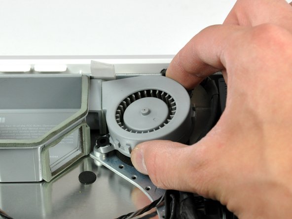

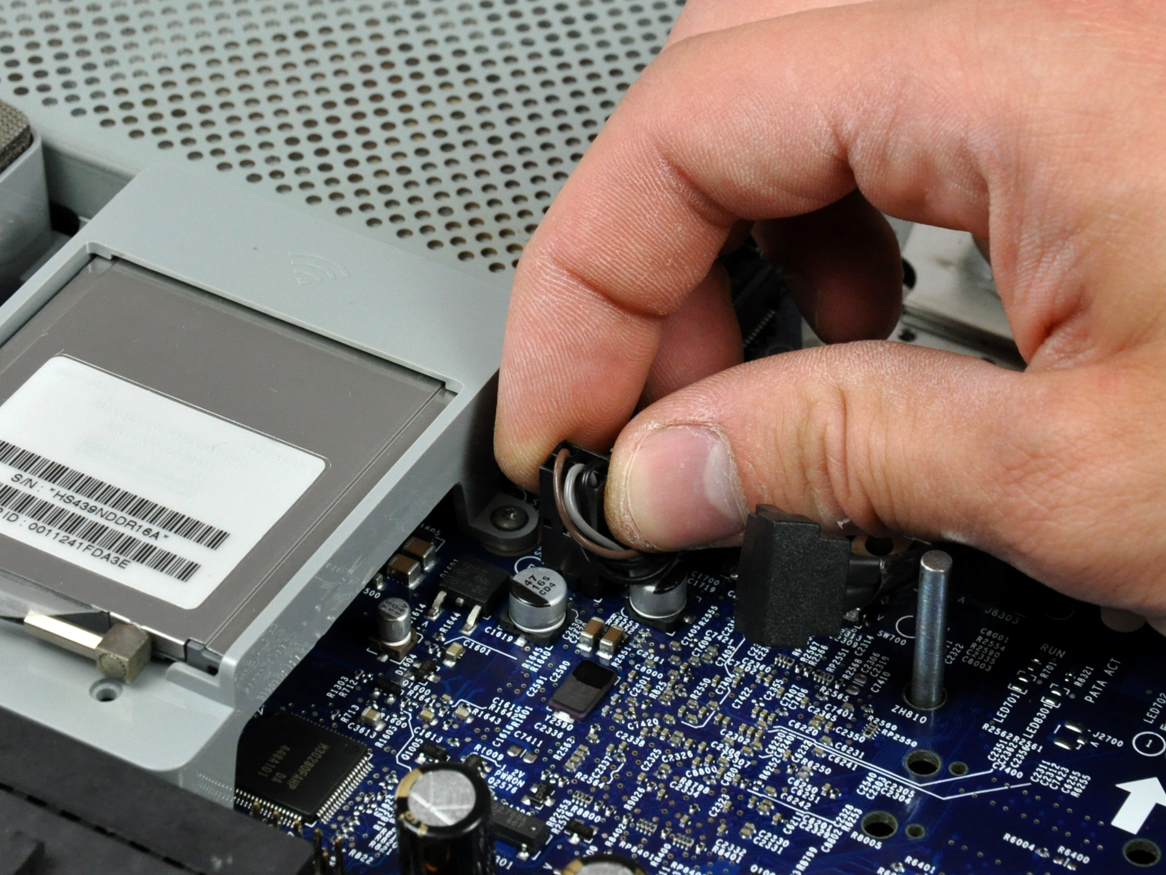

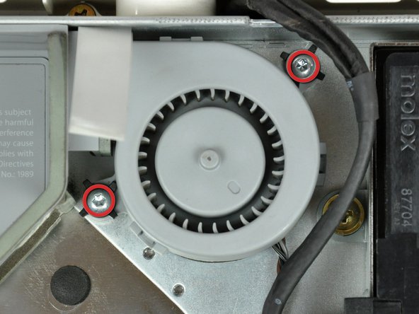

  • Remove the two shouldered T8 Torx screws from the upper right fan.
  • Lift the fan out of the chassis, de-routing the cable as necessary.
