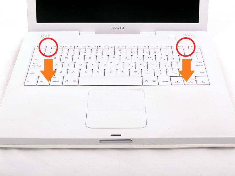

Add Note Edit Step 9  ¶
  • Pull the keyboard cable up from the logic board, holding the cable as close to the connector as possible.
  • Make sure that you reconnect the keyboard cable before replacing the RAM shield.
