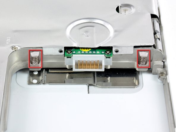

  • Remove the small greasy springs with white plastic caps from either side of the battery contacts.

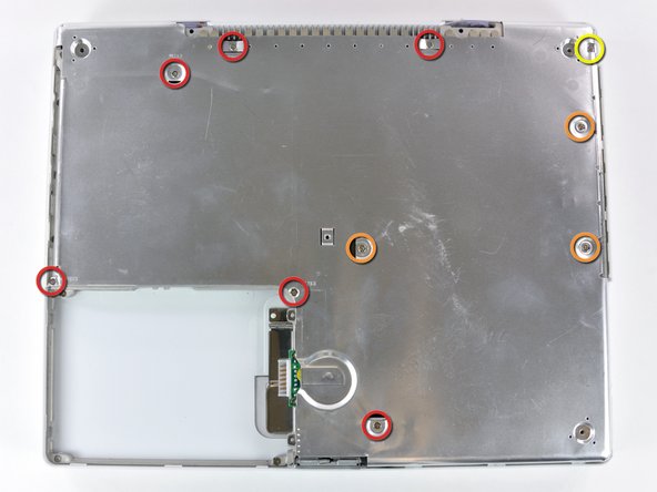

  • Remove the following 10 screws from the bottom shield:
    • Six 3 mm Phillips
    • Three 7.5 mm Phillips
    • One 14 mm Phillips

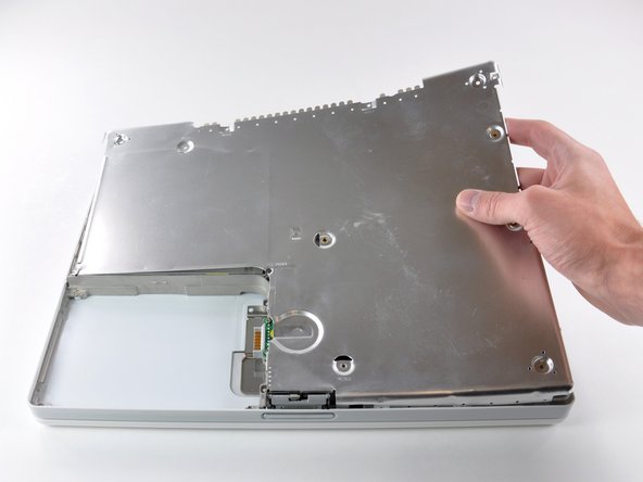

  • Lift the bottom shield off.

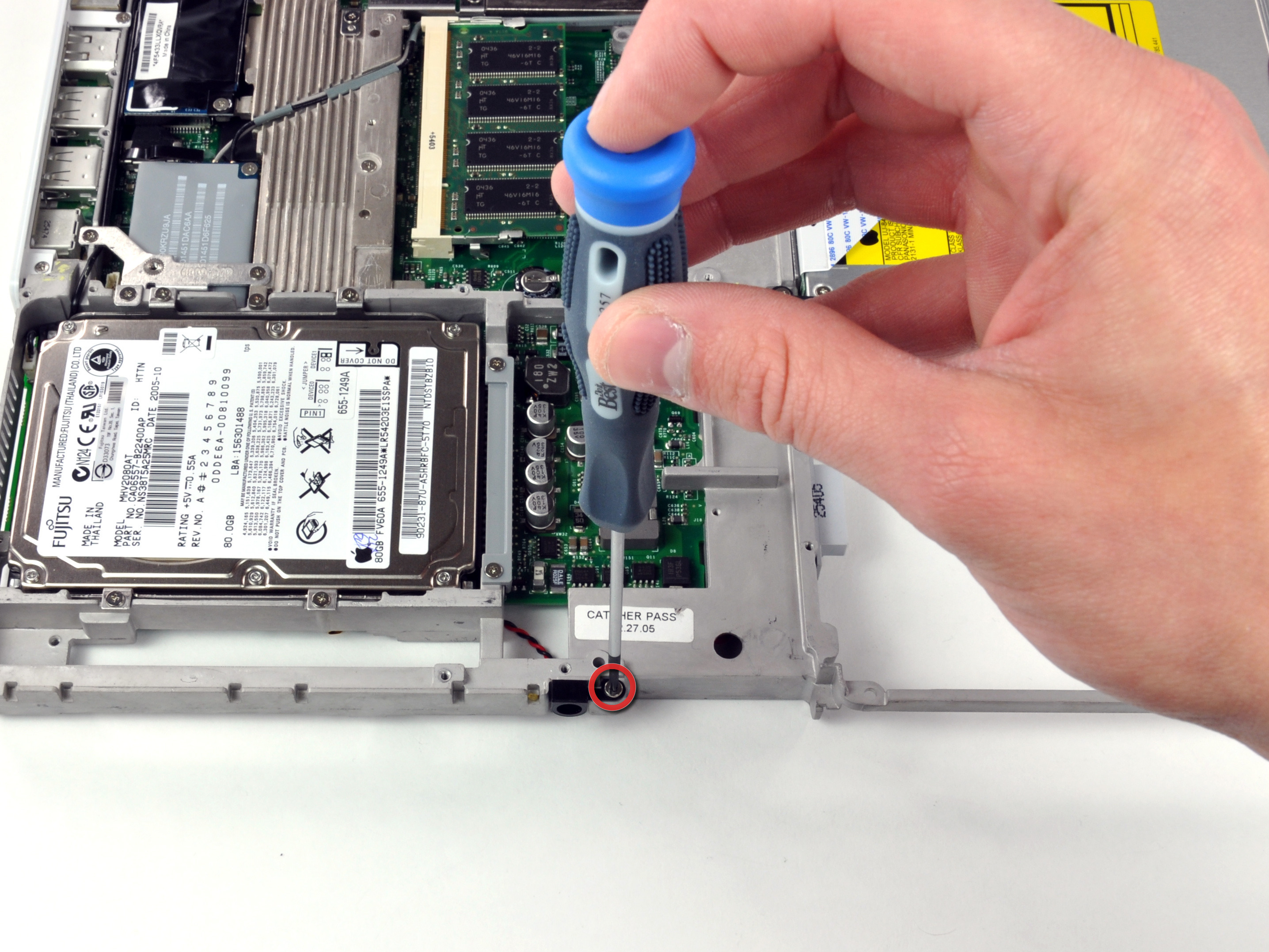

  • Remove the single Phillips screw securing the DC-In board.

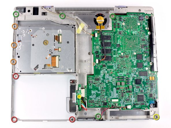

Add Note Edit Step 24 — Upper Case  ¶
  • Remove the following 11 screws from the bottom of the computer:
    • Three 3 mm Phillips around the battery compartment.
    • Three 4.5 mm Phillips along the optical drive bezel. (a magnetic screwdriver may help to lift these screws out)
    • One 12 mm Phillips in the lower right corner.
    • Four 14.5 mm Phillips.
